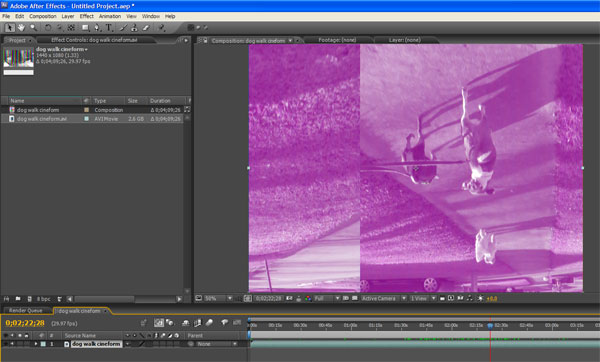

I'm having some problems getting the Aspect HD codec (trial version) to work with AE CS3.
After importing a clip that had been captured with the Cineform codec via firewire I find the video to be oddly distorted.
Click here for a screen cap or see attachment: http://img183.imageshack.us/img183/3...ineformte3.jpg
I've reinstalled a couple of times on my new NLE for various reasons and every time I've tried using Aspect HD in AE CS3 I've encountered the same problem. Interestingly enough, the same clip works like a charm in PPro CS3.
I can't believe I'd be the only one who's seen this. Any suggestions or possible solutions?

There is an AE CS3 bug when it uses Video for Windows or DirectShow it import CineForm clips (I don't know way.) That means you don't have the CineForm importer installed which has priority.
In this directory
C:\Program Files\Adobe\Common\plug-ins\CS3\MediaCore
you need to have these files:
im-CFHD_File_Import.prm
debayerM5x5Enh.dll
The easy fix is to copy these components from:
C:\Program Files\Adobe\Adobe Premiere Pro CS3\Plug-ins\en_US\CineForm

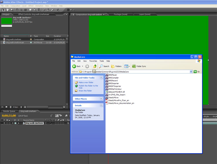

Thanks for the quick response, David. It did change how the video looks, but we're still not quite there (see attachment). It's still corrupted.
Is there maybe one more erroneously placed file somewhere?

Clearly your PC has an corrupted install. Uninstall, reboot, and reinstall Aspect HD. If it still fails, file a ticket a www.cineform.com/support and they will be able to help you.

David, I uninstalled and reinstalled to no avail. It wasn't until I realized that I was using an old trial of Aspect HD. This box is a new build so I thought I'd just reuse the trial I had downloaded a couple of months ago... but after downloading the current trial I discovered that it had been updated (duh).
It installed and gave me the "do you want to use Cineform with AE" popup (which I had not seen previously) and now everything works like it should.
