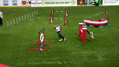

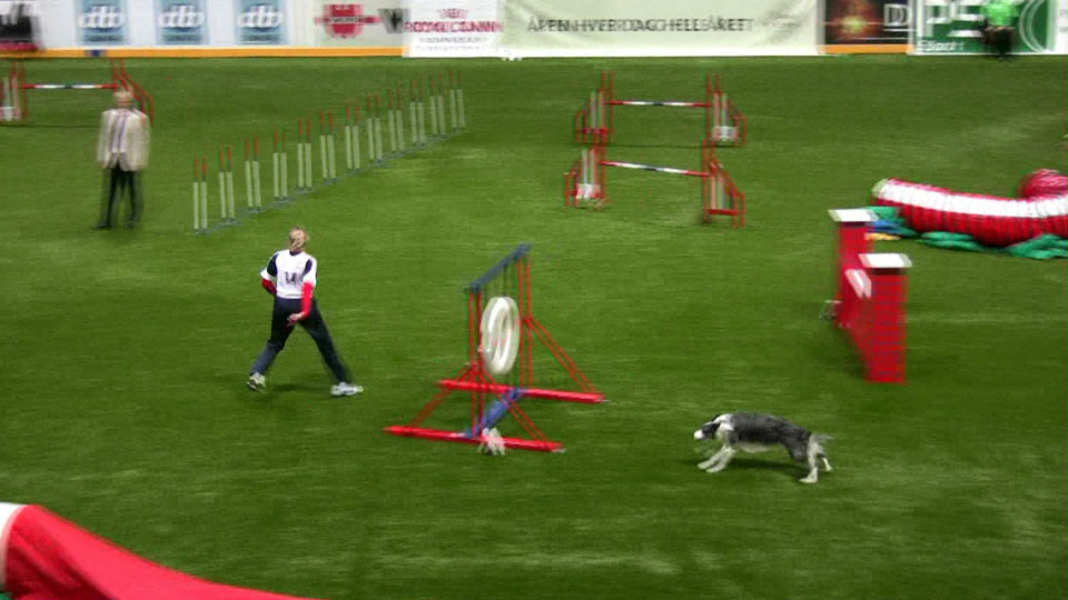

I would find the 60i to 60p very useful and a good 60i to 30p that can deal with motion, panning and motion in the scene.
I shoot dog sports, and I'm sure the HDLink deinterlacer is probably more geared toward your typical static film type shot.
As you will see in the pictures of my footage the built in deinterlacer does not handle it very well. Which I understand you can't be everything to everyone.

Set your shutter to your frame rate and the double image will go away on most cameras. Then you get the benefits of normal look motion blur and more vertical resolution. If the top field is exposed for 1/60th and the bottom field the next 1/60th, together they produce a smooth 1/30th shutter (with the right deinterlacer.) It is true our deinterlacer is targetted for indie filmmakers, if they have to shoot 60i, they will normally shoot locked down to this shutter speed / exposure time.
