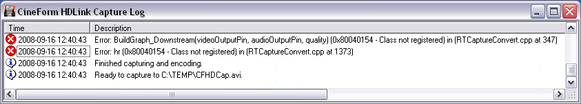

Just installed the NeoHDV 181 upate and now when I launch HDLink the splash screen says Aspect HD for Premiere Pro??? instead of NeoHDV. I am using Vegas 8.0c.
Also, i now get the following error (see attached) when I try to capture anything from my Sony HVR-M25U deck.
Thoughts?
PS. I am running Windows XP 64bit - SP2.
