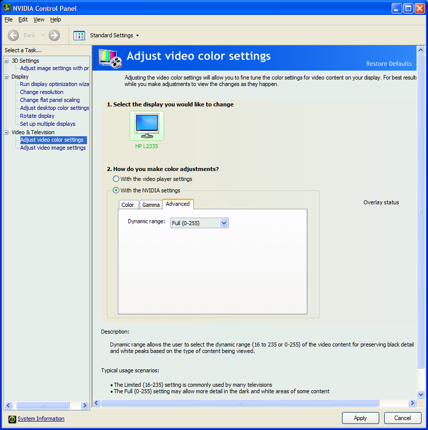

It has been years that we have recommended ATI over NVidia as NVidia cards were incorrectly outputting YUV to the DVI displays (your desktop.) We use YUV surfaces for speed, and ATI and Matrox got the YUV to RGB conversions correct, so why not NVidia?
In the latest NVidia drivers, (I just installed 178.26 for my Quadro FX 1700) there is a control panel to restore the correct video levels for a computer display. You want Dynamic Range set to Full within the NVidia Control Panel.

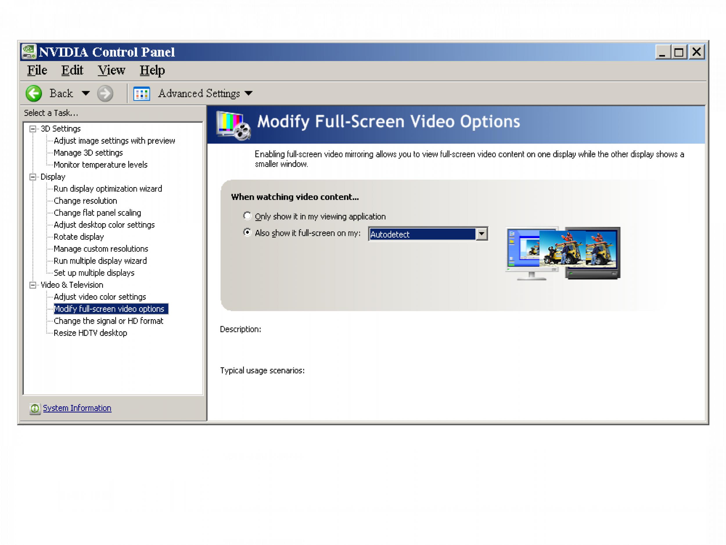

Sorry, didn't mean to belabor this, but...
The problem is that with the new driver, the Quadro cards now behave like the GeForce 8800 series, which is to say that when using Premiere with Aspect, there is no full-screen output to a second monitor during playback. The choice to manage this has been removed from the NVidia menus and the Premiere controls for this do nothing (i.e. "Enable Overlay Surface" doesn't do anything).
I don't believe any of us mentioned Avid, but glad to know it works there.
The "autodetect" drop-down I mentioned has nothing to do with resolution, but rather with output. In the Modify Full-Screen Video Options on the prior version, the NVidia control panel says "When watching video content, also show it full-screen on my:" and has a drop down. In my setup the only choice available was "autodetect." But with the new driver, the "Modify Full-screen video options" is gone so there's no way to do this.
But as I said, we filed a ticket with NVidia and we'll see what they say. In the meantime the old driver is working fine, sans the improved color handling that started this whole thread.
Note how this screen is different from the one David posted. This is from the earlier driver.
