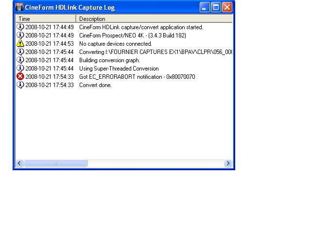

Furthur to my post above, I have downloaded and installed the latest revision of P4K. I have also re-copied the clip to a computer drive with Sony's clip browser software which would have to be right up there with WordPerfect for DOS as being non-intuitive to manage. I managed to get a playback in clip browser of the complete clip and the original is intact as is the copy on the computer hard drive.
Clip Browser offers a conversion to .mxf option. I though right - Maybe I can go an indirect route to an intact .avi file. Forget it. The next cue clip browser puts up is "format not supported". One asks, why put it there if it doesn't work? Grey out the option if it is not there. Sony really needs to do better than this.
Back to Prospect 4K. - I lowered the quality level to "high". For other conversions from the Z1, this works fine.
I selected split scenes "on" this time round to see if that would help.
The vision truncation problem remains. So for the time being the camera and editing system is next to useless in terms of getting the best from the camera. If anybody can point me in the direction of where I am going wrong with this, the advice will be greatly appreciated.
Attached below is a copy of the cineform activity log for the last conversion attempt.

Still no luck after finding there is a version two of Sony's clip browser. Used that to copy the file across. Still no joy on a successful conversion but it did go furthur into the clip before it gave up.
Maybe the cockroaches on the circuit boards moved to the right.
Got this error message this time :-
szAppName : HDLink.exe szAppVer : 3.4.3.182 szModName : hungapp
szModVer : 0.0.0.0 offset : 00000000
Time for trouble ticket I guess.

After a period of seething, missed self-imposed deadlines and episodes of the red mist, the solution finally stuck its head up.
It seems it is a case of beware the ambush of the lone FAT32 formatted drive getting in among the NTFS flock. Pure carelessness on my part.
Now a trial at Filmscan to make sure the hopes are not too far raised.
FOOTNOTE:
The clip converts fine in filmscan as a 6GB file. Just goes to show how one can become blind to the obvious, like a file that unerringly stalls at 3.99GB.
