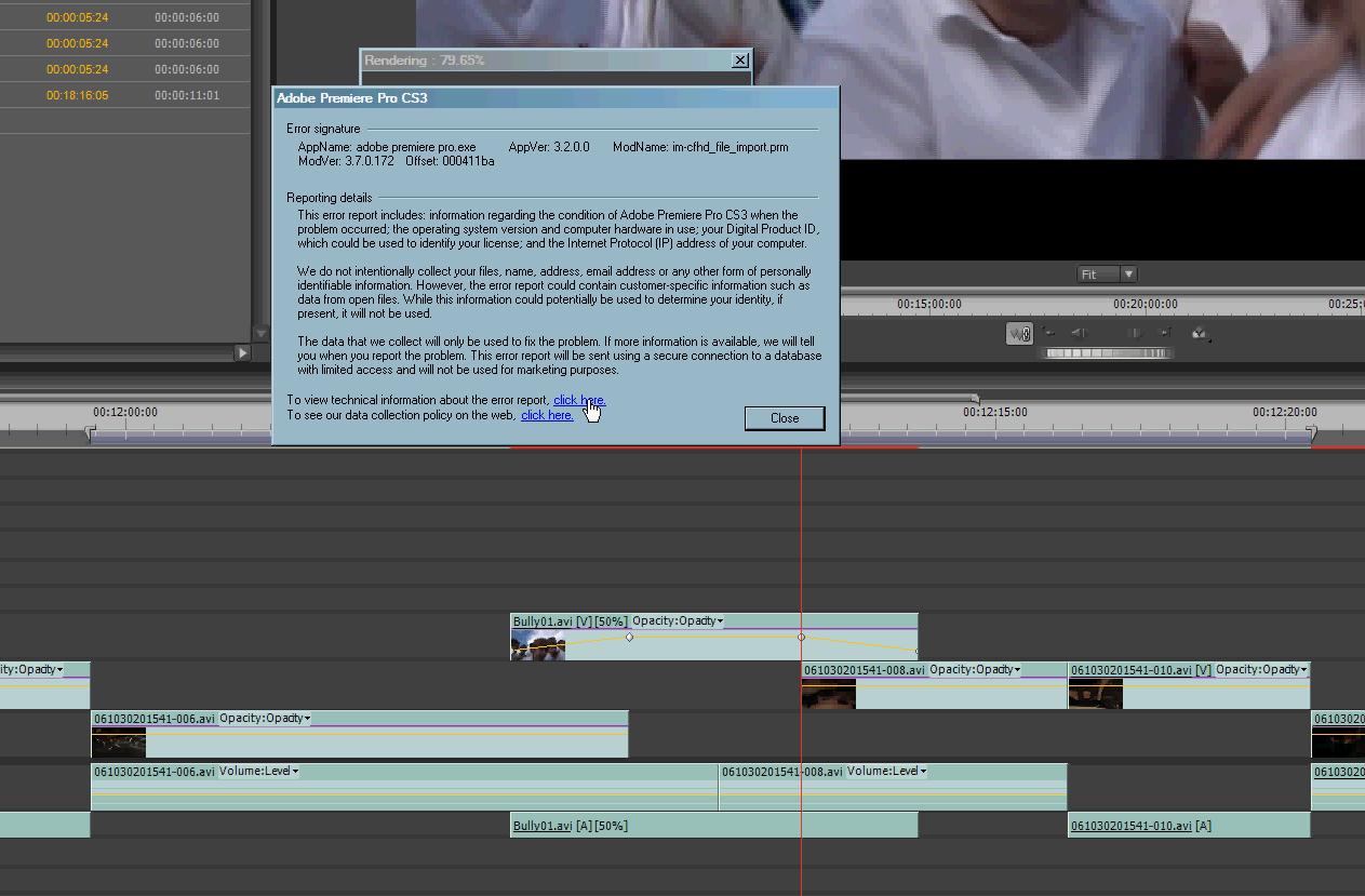

Have logged Support ticket 611-7025208 for this error - have also attached a screen dump of the error message.
Cheers, Doug.
PS - have also logged 611-7024506 for the extra frame being exported (mentioned, but no-one replied to in another thread)

I'm getting the same message when rendering in the PP3.2 timeline. The files were captered using PP2 with AspectHD v5.4.3 b127 on my workstation that I have sence upgraded to PP3 AspectHD v5.4.5 b129. Maybe that means something.

Trying new beta fixed specific piece of timeline I was exporting...
- I have had the exact same error though, randomly it seems - mainly after doing a fair bit of editing. Even when not exporting.
Will re-create error tonight and get some details for the support ticket...
