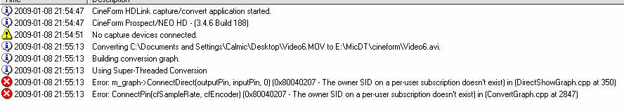

I’m using HDlink to convert Canon 5DMkii generated .mov to Cineform .avis’s. The 5Ds files run at 30 frames per second but unfortunately I get errors (seen below) when trying to render without a frame rate change ie: 30p mov to 30p avi.
To successfully covert files I must apply a 24p to 23.976p change.
Any ideas why I can’t keep the same frame rate?

this is the log generated from the above problem

Support will work you through this issue, all it means is you have the wrong demux or decoder for your source. Fille a trouble ticket at cineform.com/support
However the -0.1% speed change is a good idea as that converts the camera's 30.0 fps to a more standard 29.97p.

30p to 29.97 very easy. It is the conversion to 23.976 from 29.97/30p that is tricky.

Mike, I already have a ticket open with Cineform support, and I'm getting the exact same (and I mean exact) error entries in the log when I attempt a conversion of native Canon files to Cineform avis. I am also using the Neo HD trial.
Jake Segraves is handling my ticket there, and it's been ongoing for several days, so you might mention that if someone else is helping you.
I had never tried converting to 29.97. I was keeping same frame rate. Since it sounds like HD Link was working when you were doing a frame rate conversion, think I'll try that and report back just for kicks.

It seem like you had a solution by converting to 29.97 (which is a good idea anyway.) I've prompted support to follow up. There is likely an additional component on you PC that is interfering, we just don't know what it is.
