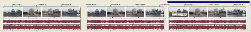

It might be worth sending a note to AC3filter.net, but there is nothing CineForm can do if there is a problem in that component, short of recommending another. That all said, I'm not seeing any issue here. Waveform all look the same: native Vegas vs Cyberlink Audio Decoder vs AC3filter.

Aha! I had an older version of the AC3Filter that created the problem! I uninstall it, installed the new one, and it now works perfectly! Thanks! My version was 1.09. Latest is 1.51 as of now.
