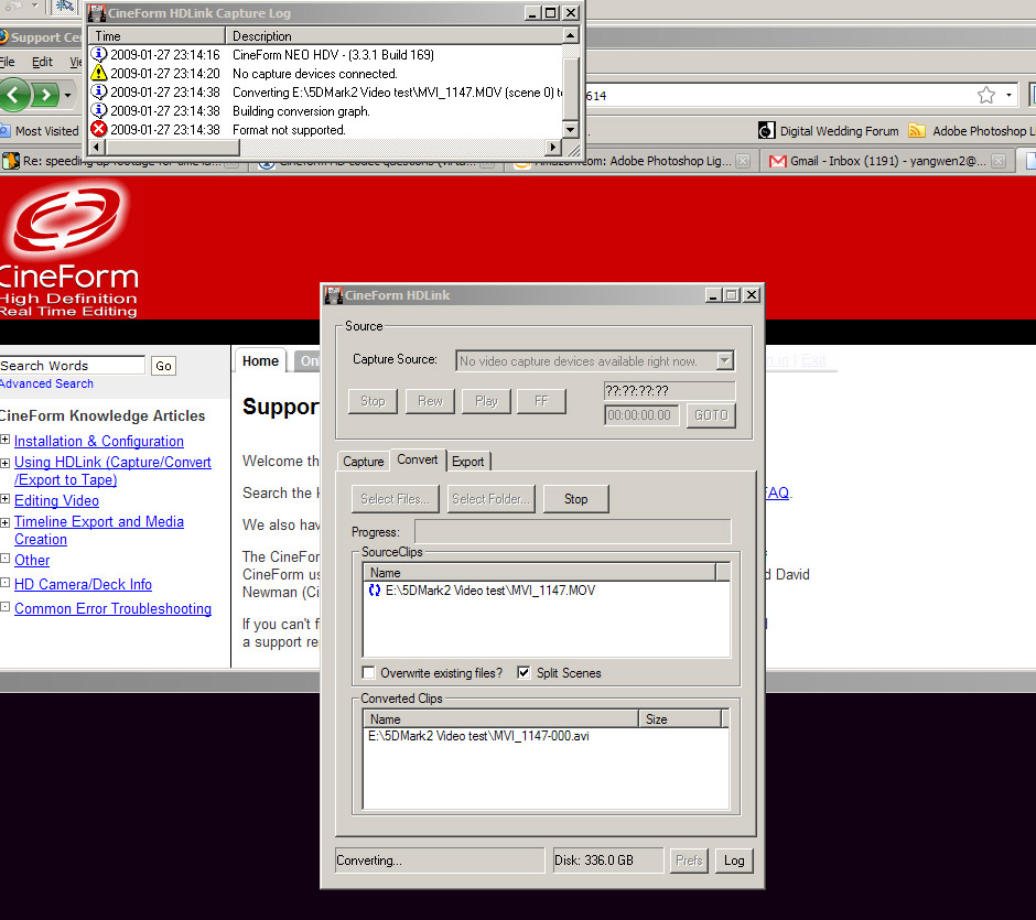

EDIT: David.. I followed your directions and get a format not supported error in the Capture Log. However, the video shows up in the Active monitor and it goes through all the frames in the video and then says "Convert Done". However no new video was created. In Preferences, I have these options "checked" Destination File format = .MOV, Medium Quality, Maintain Audio Pitch, Keep Source Aspect Ratio, and Resize to 1280x720
I've attached a screenshot showing the application error..

Old January 28th, 2009, 04:51 PM   #11
Sponsor: CineForm
Location: Carlsbad, CA
Posts: 153
Originally Posted by Yang Wen View Post
Awesome Thanks David and Keith!
Make sure you have Core AVC installed and use the latest build of NEO HD (download from our website).
If it still doesn't convert, try renaming the .mov file to an .mp4 file and if that doesn't work open a ticket at cineform support.
Jake Segraves is offline   Reply With Quote
Old January 28th, 2009, 07:54 PM   #12
Join Date: May 2003
Posts: 991
Jake, just to confirm, you meant Neo HDV right? As David's instruction to me was for Neo HDV...
