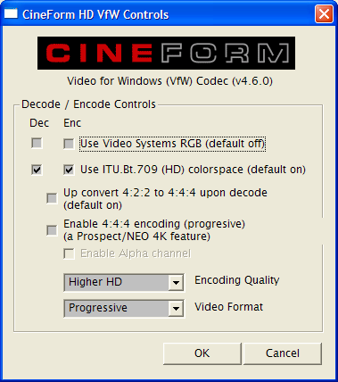

CineForm HD Encoder (low memory) and CineForm HD Encoder-2 (highest performance) are DirectShow codecs. Anything with Vx.x.x. is a Video For Window version of the codec, there is some name caching happening so that you are seeing older version numbers, but they are likely the same version (as it is only stored in one place.) So I doubt you are using V3.8.2, if you open the codec settings the current version is shown.
This points to Procoder doing something wrong. Note: HDLink supports 30.0 to 29.97 conversion. If you want to do it the fastest way, using a AVI frame rate tool -- AVIFrate, to change the play speed in the header.
