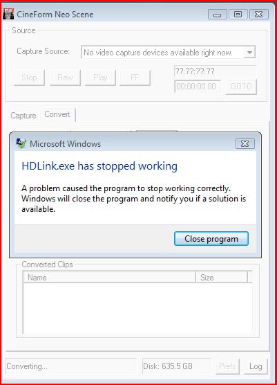

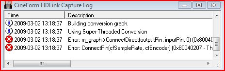

Okay, uninstalled everything. Reinstalled Neo HDV first. Tested it, and it converted a file fine (A cineform capture, and I told it to remove pulldown) .
1. I then installed Neo Scene. In the installation, it defaulted to the Neo HDV directory. I let it do that. Then when I tried to call the HDLink up, it brought up the Neo Scene trial, and I could not call NeoHDV.
2. I uninstalled all, and reinstalled NeoHDV again, in a NeoHDV directory. I ran a conversion.. Worked fine again. I then reinstalled NeoScene. This time I selected a separate NeoScene directory to install into. I called up NeoHDV by its separate NeoHDV HDlink, and when I try conversion, I get the error message produced in the jpeg below. In addition, Neo Scene stops working also. See the error it show in second jpeg.
Any other way to go ?
Edit: After uninstalling NeoHDV, I tried to use NeoScene to convert a 5D file, and it still errored out. I uninstalled, and reinstalled, and it worked fine again.
Can I Run NEOHDV and NEO Scene at Same time-neohdverrormessage.jpg   Can I Run NEOHDV and NEO Scene at Same time-neoscenecrashview.jpg

Oh well. Sorry about that. When NEO HD v4 is out, you will want to upgrade to that anyway, solving the issue.
