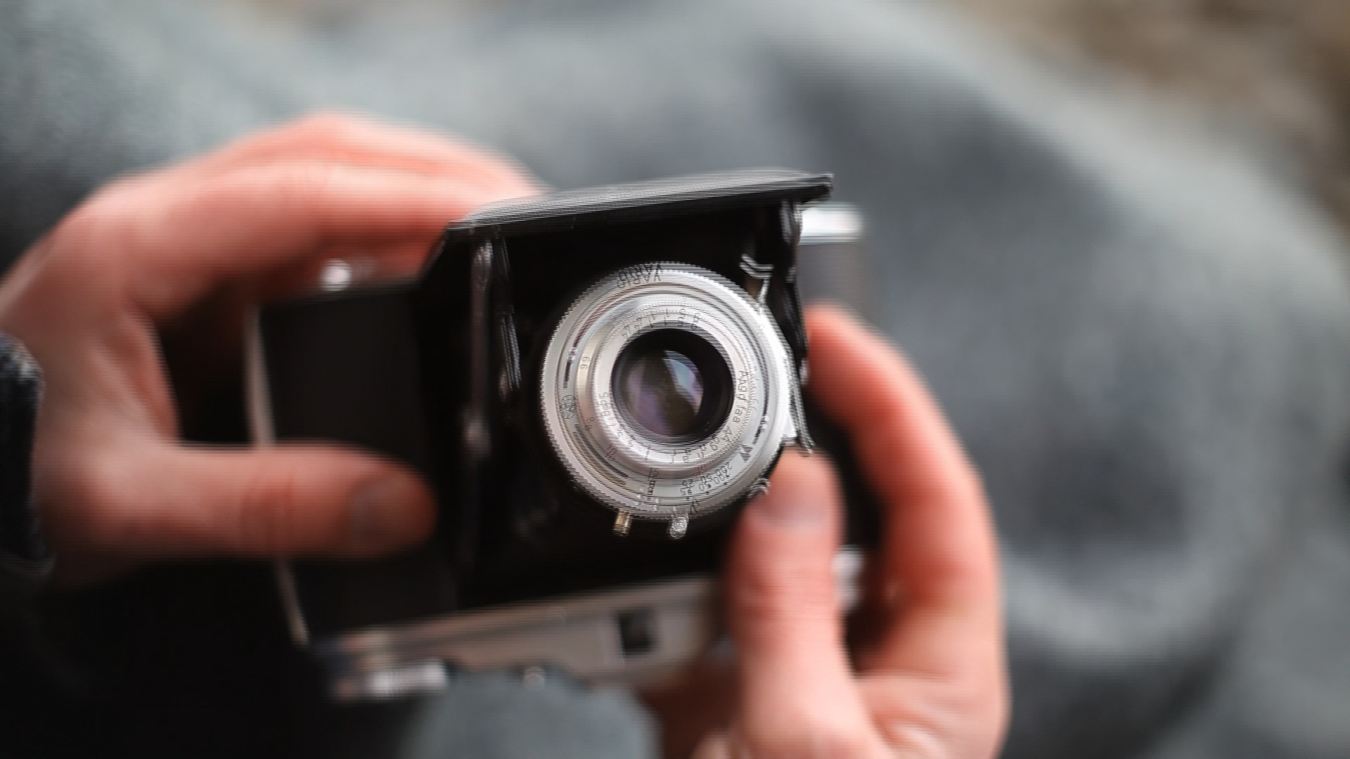

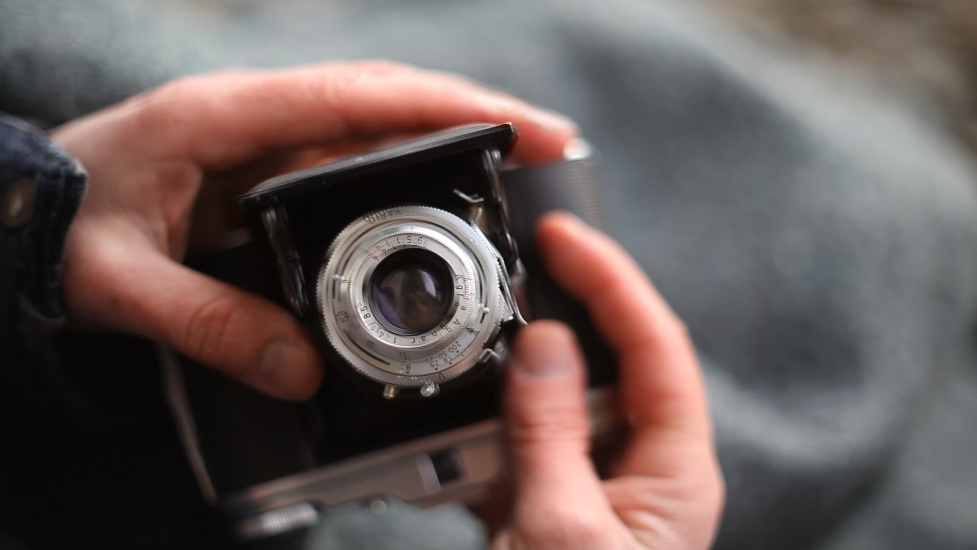

Hey guys, after using Neo Scene 1.1.0 on my PC to convert my 5D2 footage for a week, I was quite impressed and bought it. After a shoot on Sunday, I converted my footage as usual (quality high, convert to 24p) and to my surprise, found that several of the clips now had the issue you see below. The original .movs were clean, no issues. This shows in both Windows media player and Vegas 8.
I rendered some of them again, thinking it might have been a fluke, and there was no change.
Any thoughts?
Edit, the horizontal splits are much finer than what the photos here display... not sure why it's changed after I uploaded them to DVinfo.

Try VirtualDub to preview your AVIs. This looks like part of you processing added pulldown, we don't ADD pulldown.
