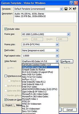

Following your directions, I went to render a master in cineform avi.
IN my Vegas program I look under AVI and i see nothing that indicates that the codec is in there.
I have neo scene, is there something i missed about getting that plugged into my Vegas program?
I shot in HDV 60 interlaced. In properties i have it as 1080 P with deinterlacing as interpolated.
I am not sure of where to go from here.

The codec is there otherwise you are not using CineForm, the encoder and decoder are the same component in Vegas. The codec is listed as a video for windows component. If you can't find it you need to talk to support.

I went to support and as it turned out the
CFHD.dll file is not to be found in the vegas or system 32 folder. I am waiting back for a response to see if I need to reinstall Neo scene.

All is well in the universe. Between support and Davids help I am on the right path and all is well.
I reinstalled neo, that put the codec back in the computer, It was right where David directed!!
