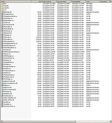

here's the list of what I assume are the drivers in the Common Files\Cineform location:
(or are they in another location?)

Tim, I think I found the problem. I found a CFHD.INF and CFHD.DLL in the System32 folder. When I renamed them just to check, the HDLink loaded normally.
I'll check with Premiere now and will only respond here if it's not normal.
