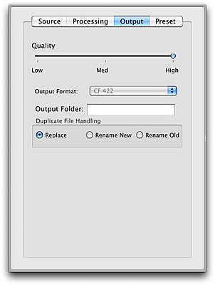

As there was a new version of NeoScene released last week I though that I would try it again. I downloaded the demo version today but I cannot access the option to choose between CineForm & ProRes as Output Format. As soon as I click on the drop-down menu it greys out & only CF 422 is ticked as in the attached screen shot
I do have FCS installed & ProRes is available to other applications like MPEG Streamclip

Nigel, it sounds like your Trial of Neo Scene might be expired. Contact support at cineform dot com and they can get you a new Trial ticket.

David, that was it. Thank you. I had tested a previous trial version some weeks ago.
