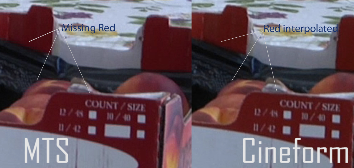

I see clear examples of Cineform 4:2:2 filling in (interpolating) missing color samples, especially in the reds and oranges. So how do you classify adding Red pixels to round red objects that appear MUCH smoother than the original HDV or AVCHD files?
I'm not sure what your reasoning process is, here. One cannot create something from nothing. For example, if you're on the edge of an object, interpolating the missing color data can be very incorrect. I would be very surprised if Cineform did this. It would just be wrong. Once again, at the risk of being repetitive, one cannot create something when nothing is there to begin with.

My reasoning process is visual observation...Cineform adds back in the Color information. Double click on the image to see.
Plus on the their website the clearly state the interpolate 4:2:0 up to 4:2:2
Send an email to David Newman. He can explain it much better than I can.
I have many more samples if needed. Take a look at your own Cineform footage and compare with the original.
PS-you can create something that is not there. If I give you two points some distance apart, you can creat a line.
can you get 4:2:2 from 4:2:0-mts-cineform720-60p.jpg
Andy Urtusuastegui is offline   Reply With Quote

Images: 10
You're still missing the point. Of course you can draw a straight line between two points, it's called linear interpolation. The question is, is it right? In physics, lines are rarely linear. They could be power functions, or an infinite number of other permutations. To assume it is linear is generally a bad guess. And that's all it is...a guess...and not even a good guess.
