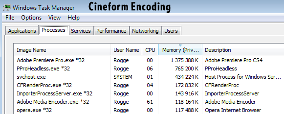

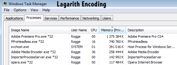

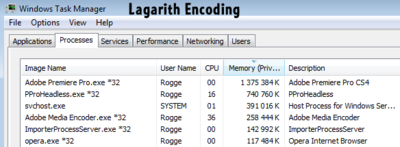

My results with a still PNG with motion and is:
Lagarith, one minute 1920 x 1080, 25 fps, interlaced Timeline: 1 m 08s.
CineForm, one minute 1920 x 1080, 25 fps, interlaced Timeline: 4m 02s.
Why do we get so different results?
Processor: 2 x Intel E5450 (3.0 GHz)
RAM: 16GB FB-DIMM
OS: Win Vista 64-bit
CF Codec version: 5.1.4
Memory usage: See attached images
- When Encoding to CineForm HD all eight cores pegs at around 69%-87%.
- When Encoding to Lagarith all eight cores pegs at around 50%-57%.
Export to CineForm AVI - Whats the catch?-cineform_encoding.png   Export to CineForm AVI - Whats the catch?-lagarith_encoding.png
