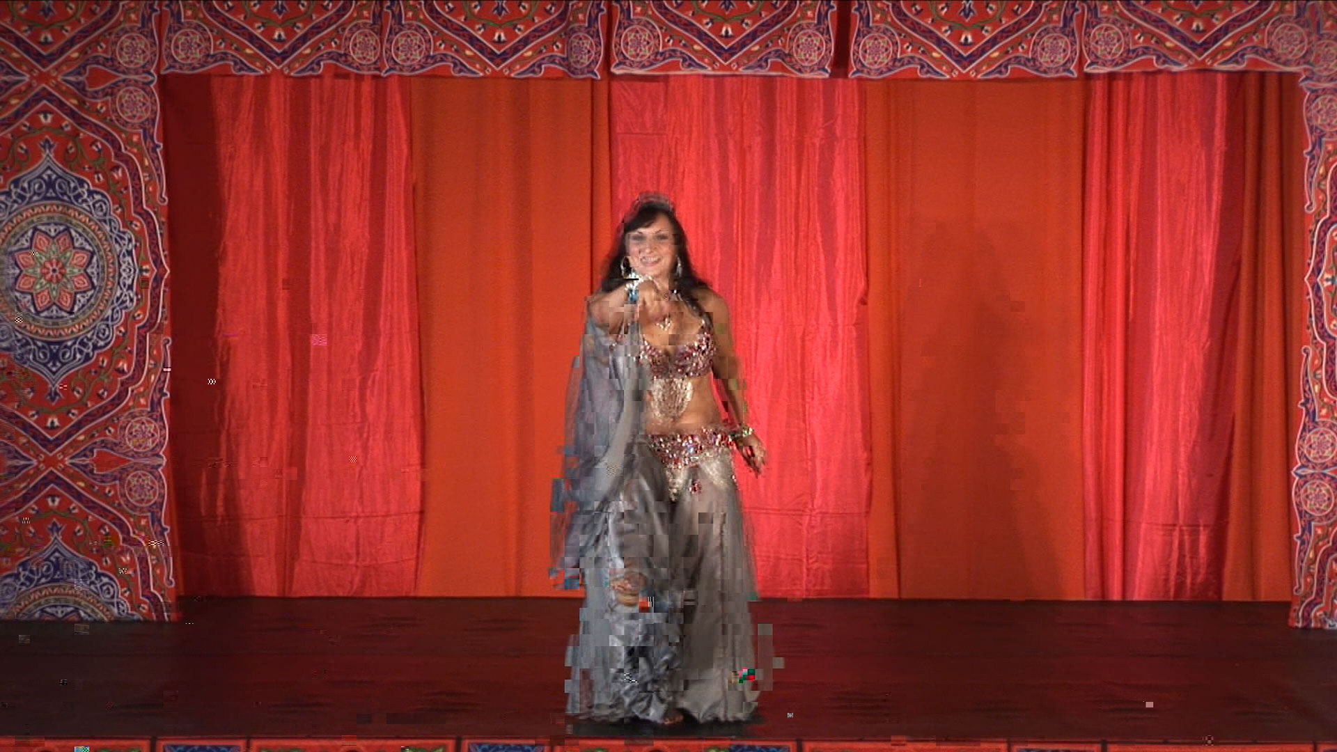

I've attached a frame capture from Premiere Pro, from one of the files. The dropped frames are different from conversion to conversion--just gotta compare to the original M2T until you find it.
