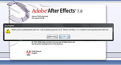

A couple months ago I downloaded the trial of Aspect HD. It seemed to cause nothing but problems with Premiere, so I had to uninstall it. Premiere works fine, but oddly enough the Cineform presets still show up in my list.
edit: I did a search for "cineform" on my C drive and found the folder of presets was still located in the Premiere folder. I deleted that, and they are now gone.
My big problem is no After Effects won't open!
As soon as I try and open it, I receive this message (see attachment). Upon clicking anything, AE crashes. I can't even move that window without it locking up.
I've uninstalled the software....it doesn't show up in the list in my add/remove programs box...how do I get this out of my system? I can't find any cineform folders in the AE folder, and I have tried reinstalling the software.
I'm not afraid of using regedit if someone can give me a list of what files aspect HD puts in there.
Wade Spencer is offline   Reply With Quote

Somehow you original install was bad as the uninstall typically removes everything. The only components AE may still be using is the CFHDIO.aex module within the AE plugins folder and CFHD.dll within windows/system32. Of course if you install the latest version of Aspect HD will likely find
no more issues. If you want another 15-day trial yet me know.
