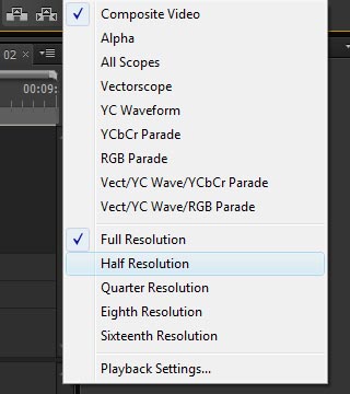

Sergio,
I'm not sure if you are aware but.....
If you install the RED importer in CS4...and edit Cineform with a RED timeline preset....
you have a dropdown window which lests you choose all the way from 1/16 to full rez...
I edit RED generated cineform 4K RAW at 1/2 rez at 24FPS with a core i7 and 12 gig, I can sometimes get 24FPS at full 4k (RAW) and most of the time I run at 1/4 rez just to make it a little snappier, the point however is you can edit cineform and cineform raw at real time on CS4 right now.
Most people do not realize this because they are waiting for the cineform presets, but the red presets work just fine for the multirez trick.
No need to offline or proxies...
even at 1/4 you should be able to edit 2k on a good laptop...on 4k half rez my i7 CPU's are only pinging up to 35%

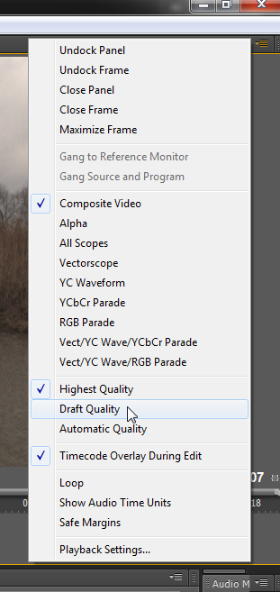

Thanks Mike. I also use CS4 as my primary NLE, and it is always real-time in the half res. mode (The Draft Quality selection in the program window,) and mostly real-time Highest Quality mode on my home 920 i7 (not a fancy desktop.) All this works without the Red importer (it seems a low res modes, but I don't need those.) This is with SI-2K footage, 2D and 3D footage, with and without First Light color corrections. Reason CS3 seemed so speedy it defaulted to half, most didn't realize or care, there were a couple of other tweaks that made PHD CS3 very fast, but only in straight lines, wasn't so great at cornering. The reason I use CS4 over CS3 (and I can easily use either) CS4 is faster at play-stop transitions, J-K-L controls work better, audio playback sync in preview better, other effects filters would play without rendering. So CS4 is not all bad. If we hadn't made CS3 so fast, we would be having this discussion now. Our CS5 implementation will be more like CS4 behavior, but with more speed.
Update - CineForm Adobe CS4/CS5 Support-halfrescs4.png
