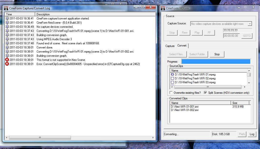

This CineForm idea isn't really going anywhere. I don't really have the time to try and get what is essentially a brand new product installed on a clean and patched OS working. I logged a call with CineForm and they sent me a link to download build 5.0.4.261 which I think is supposed to fix issues with converting HDV 1080i PAL to Cineform. Alas, it's less successful than the latest version.
If you have a similar problem and you want to tie in with my support reference number, it's #611-8308823. I've attached a screenshot of the recent issue on this build. Probably something wrong with my clean Vista 64 install. Poo! :-(
Kind regards,
Andrew.
Professional Wedding Videographer and Wedding Video Production Services in Bolton, Manchester and all over the UK
Any programs / codecs known to conflict w/ Cineform?-cineformerror.jpg
Andrew Prince is offline   Reply With Quote

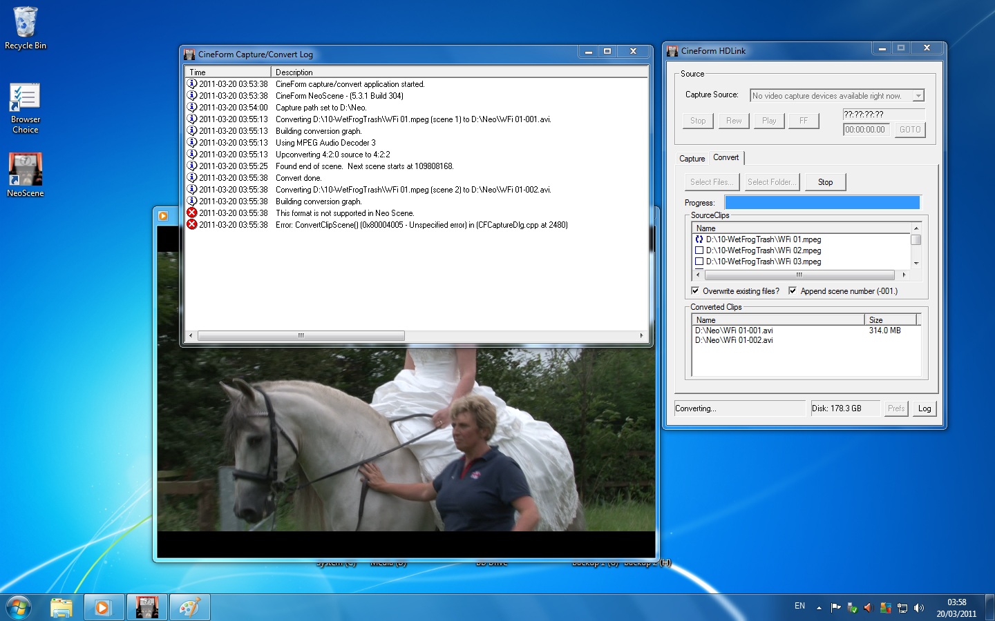

Old March 19th, 2011, 10:06 PM   #13
Join Date: Aug 2010
Location: Bolton, UK
Posts: 49
Re: Any programs / codecs known to conflict w/ Cineform?
Hi all,
The saga continues.... I upgraded to Windows 7 64 bit (that is, I bought Win7 64 OEM and rather than install it, I upgraded Vista 64). Works a treat, except with my footage.
Before, I couldn't play Premiere Pro CS5 captured HDV 1080i from my Sony Z5E or Sony FX1E. Now with Win7, I can finally play my HDV footage through Windows Media Player. However, Neo won't convert them.
Screenshot attached. I'm out of ideas and I think I will just have to continue editing straight HDV.
Regards,
Andrew.
Any programs / codecs known to conflict w/ Cineform?-neo_fault.jpg
