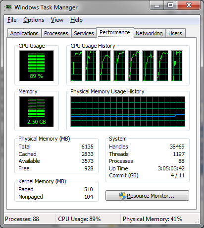

Weird, my
Win 7 64bit
I7 920 processor
6 gigs ram
ATI Radeon 4850 HD
uses 90% CPU converting AVCHD, and does so very fast, about 2-2.5X real-time.
