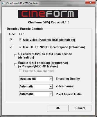

3) The easiest. Set the decode to default to Video System RGB. Import any CineForm clip into VirtualDub. Go straight to setting you video compression, and select CineForm, and click on "Configure". Set Video Systems for encode and decode.

Thanks, I thought that might be the case but I wasn't sure where to correct for it. I guess I need to read up a bit on YUV and find the best pipeline. I used your third suggestion, it seems to work well. Everything I do with video to date is intended for PC playback anyway.
