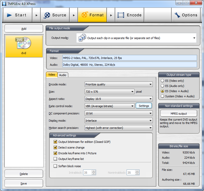

Old April 11th, 2010, 12:23 PM   #4
Location: The Netherlands
Posts: 710
This is what i use. Set interlaced to progressive.
Old April 12th, 2010, 04:22 PM   #5
Location: Stockholm
Posts: 133
Thanks Ann and Leo
Leo I use CBR, just find the result to soft and un sharp for my approval.
Perfect Ann with your pic, just got two more question.
1. Can I select "progressive" instead of interlace in the submenu "Displaymode", will I gain any quality (I know dvd is interlaced)
2. How do you deal with the color space 709 (HD) to 601 (SD) then? if you come from HD like 720p or 1080p?
Best Regards
Mikael
Mikael Bergstrom is offline   Reply With Quote
Old April 16th, 2010, 07:38 AM   #6
Location: Stockholm
Posts: 133
Thanks Ann
Your preset works like a charm:-)
