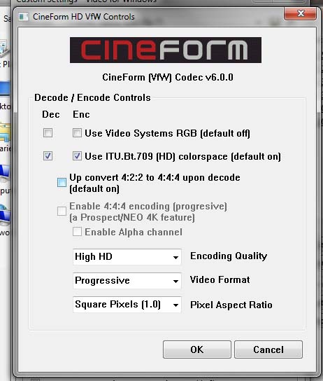

Is there a default setting for these controls and what are there situations where you would use one setting instead of another? I am working on an hour long project with Cineform files and have a number of different sections which I render out to Cineform AVIs to later render to Mpeg for Blu-ray. I've been having problems in getting a few glitchy little things in random places in the rendered AVI file. I can do work arounds like cutting the glitch out of the final render and putting in the unglitchy bit from what I originally rendered. All of this has led me to question the HD Vfw Controls settings and how it should be set. Maybe that's my problem.

It might help if you could post a frame capture of one of the "glitchy little things in random places". You're better off on this kind of issue to file a ticket with Cineform support. In any case, I doubt that any of the VFW codec settings would cause that type of random problem. I attached the codec's property sheet. The first two items have to do with color, the second of which should be left as the default for HD. The third item is if you are working with 4:2:2 material, but that should only affect the decode. The three bottom items affect the encoding to CFHD, but they only control file size/quality, progressive/interlaced and pixel aspect ratio (1:1 for 1920x1080, etc and 1.333 for HDV formats). In general, you should use High HD for the quality setting.
