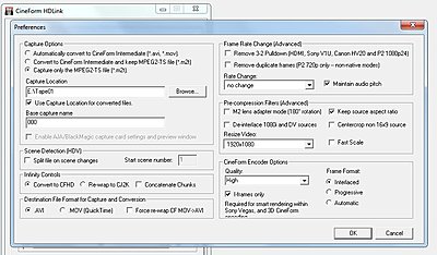

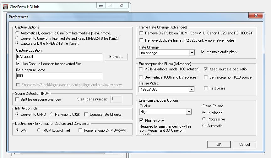

Okay I have source files so I can get all the footage in the same rates but having a little troubles.

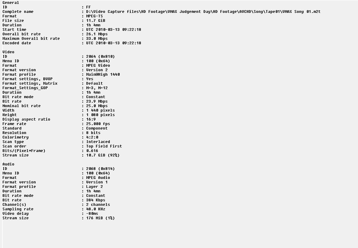

So I can see my captured file from HDlink is interlaced; fine great!(Z1E) But I need to resize the footage to 1920*1080 to suite the CX-105E

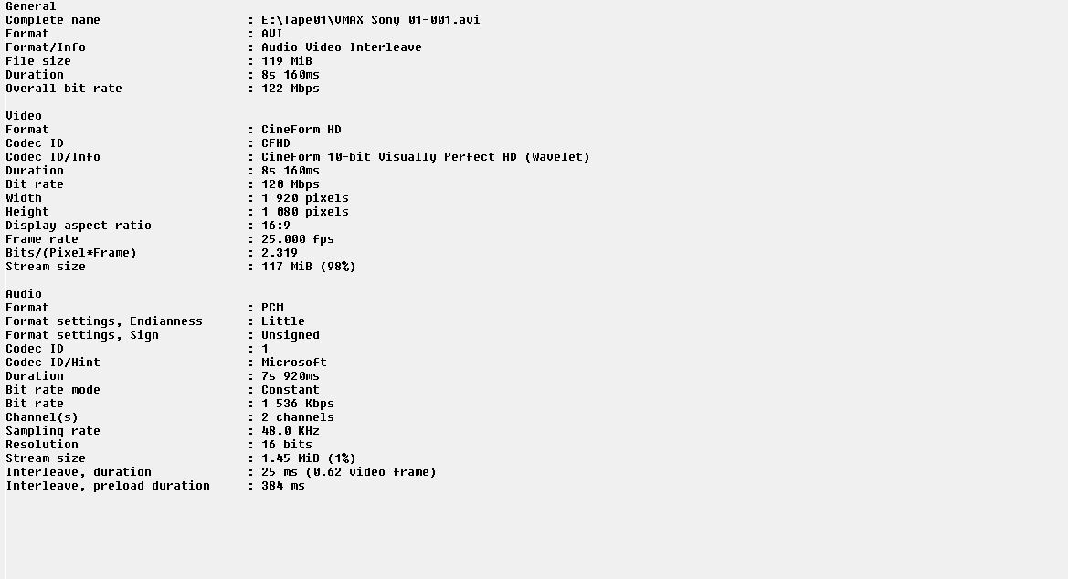

Is my CFHD converted file interlaced? I can't tell?
HDLink - Deinterlace-cf-master.jpg   HDLink - Deinterlace-cfhd-converted-file.jpg

Old April 28th, 2010, 08:43 AM   #5
Location: Chester, North West
Posts: 565
No I used MediaInfo. Remind me not to google g-spot in work without thinking twice!
