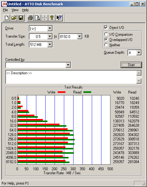

ATTO Disk Benchmark:
Hello,
I just tried the ATTO Disk Benchmark on my raid 0. What are considered good results? I attached mine to this message. I have never done this before so I don't quite understand the results.
I just want to verify that my system is running well.
I am using PPCS5, 12 GB of ram, x980 CPU and Sata drives at 7200 rpm. I have 3 drives at RAID 0.
Simon

The Cineform encoder "High" setting creates files with a data rate of 16 MB/sec. Your results are excellent for a 3 disk RAID0 array (~250 MB/sec write speed and ~300 MB/sec read speed, as you can ignore the small block size transfers).

Hi Jay,
Good to hear. I was not worried but was not sure how to interpret it.
Thanks again,
Simon
