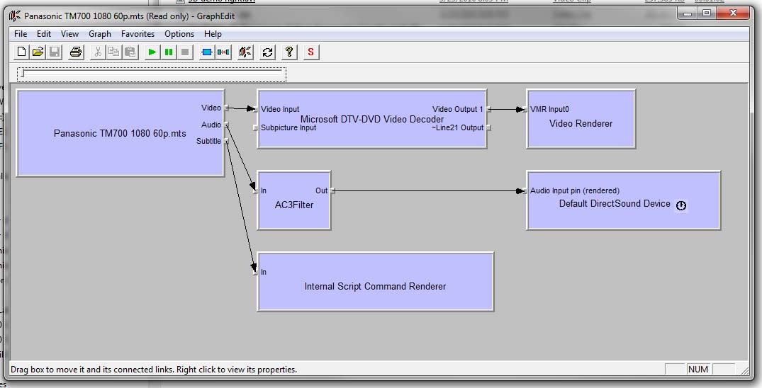

Attached find the DirectX Filter Graph from Windows 7 x64. A native TM700 1080 60p file converts fine with Cineform HDLink, plays in Windows Media Player and is editable in both Premiere Pro CS5 and Vegas Pro 9e. The video codec appears to be H.264 Level 4.2, which probably causes some older systems to either not display it properly or at all.
Will/does Neoscene support the HDC-tm700?-panny-tm700-directx-filter-graph.jpg
