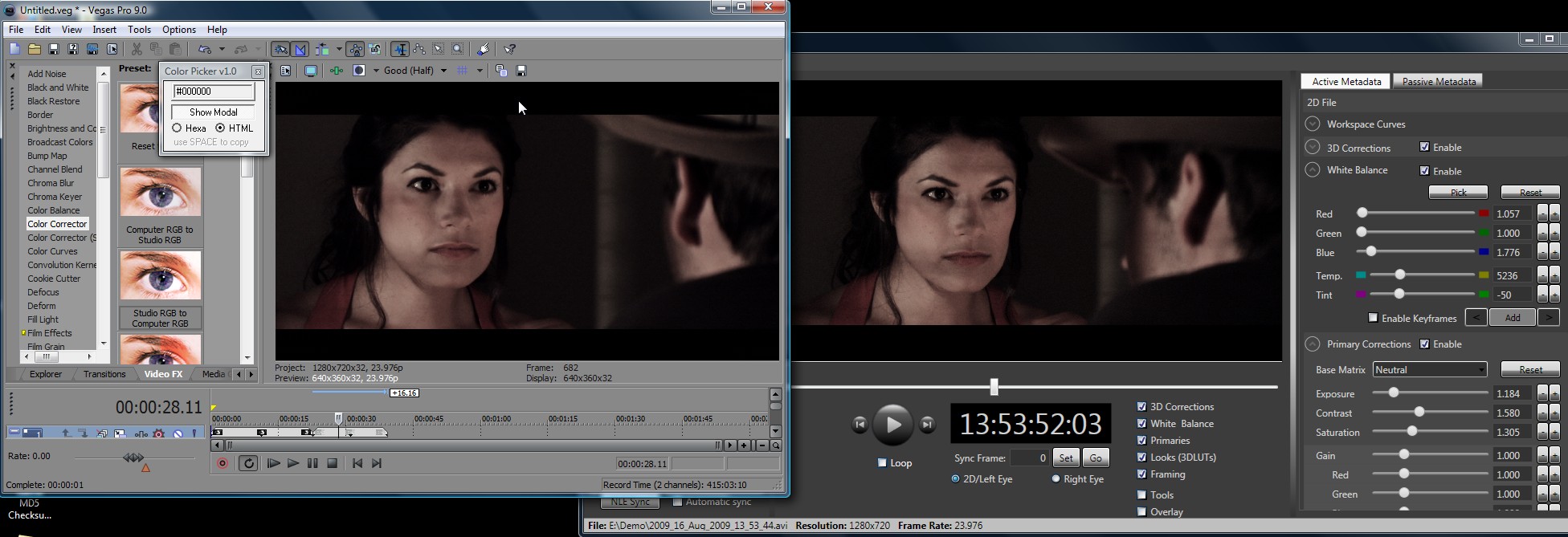

Filter (Vegas matched FirstLight -- first image)

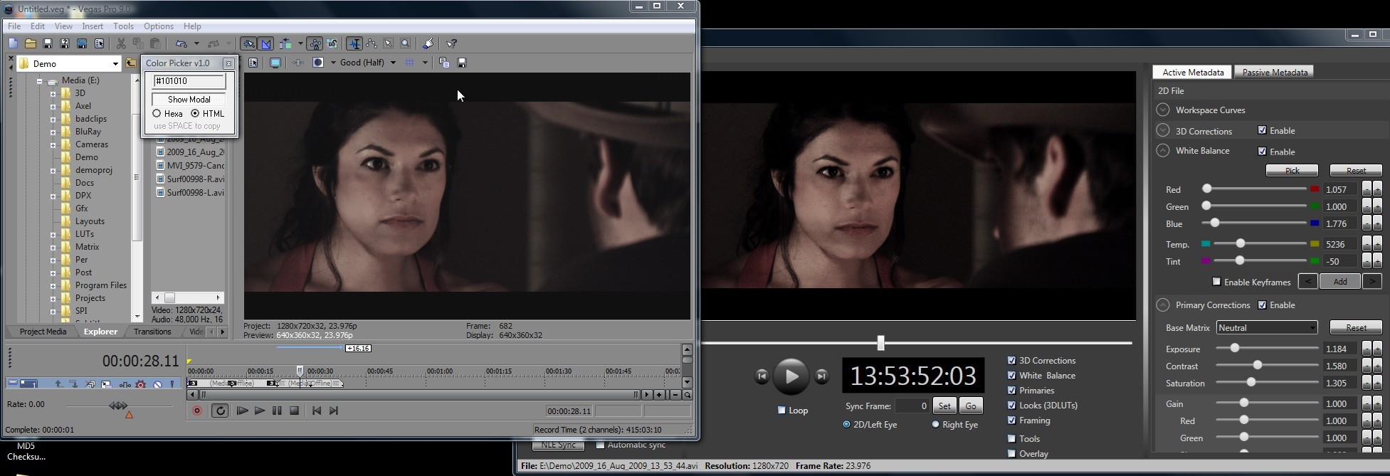

Unfiltered (Vegas is wrong -- second)
I added the ColorPicker to show the blacks level:
#00000 is 0,0,0.
#101010 is hex for 16,16,16
First Light why so different?-filteron.jpg   First Light why so different?-filteroff2.jpg
