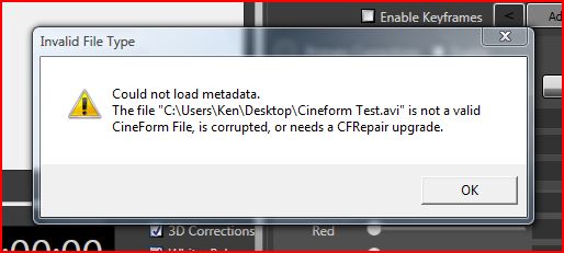

Updated NEOHD to 5.0.5.264 now First Light Won't Read Cineform .avi's
...maddening. Says can't read file, both exisiting Cineform .avi's as well as ones I just converted with HDLink.
I get the message below.
So I also tried CFRepair...couldn't get anything but a message saying I needed an .avi output file...
Worked fine until I did the update...any ideas?

I get the exact same error message here, rolling back to v.5.0.4.261 fixed it.

Dear David, I got the same message as Ken on older files, went back to v.5.0.4.261 like Galen suggested and First Light recognized them all again. It must be a problem with First Light 5.0.5.264.

Patch for FirstLight 5.0.5
Here is it: http://cineform.com/downloads/FirstLightv505patch.zip
Unzip and replace FirstLigh.exe in
C:\Program Files (x86)\CineForm\Tools (Remove the " (x86)" for the 32-bit systems.)
The failure was an overly strict check the CineForm sample header (required to fix a 5.0.4 bug,) plus a typo resulting in no support for I-P encoded files. We've pretty much switched to I-frame only (required for 3D) so we missed this in our testing. All works now, and this will be in the next official build

Thanks, that seems to have done the trick! Seems to work OK now.
