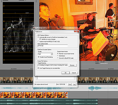

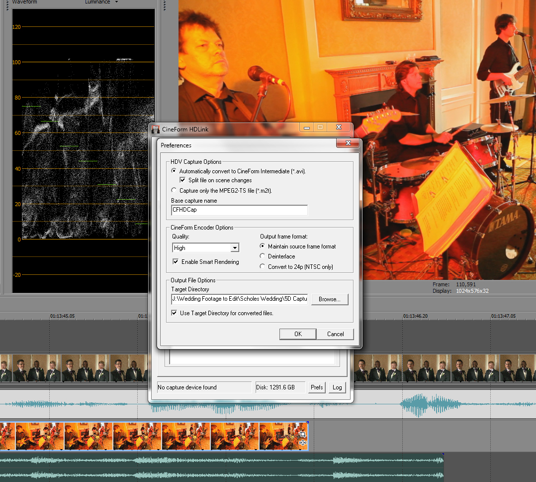

CFHD is set to high quality. See atched JPEG for screenshot of Vegas (see audio is longer than video) and you can also see Neoscene settings.

"...and at the time of CFHD conversion of your High setting, what is the CPU utilization?"
Not sure, I'm not doing a conversion at the moment. Why would that matter though? Even a 8 core PC would surely utilize 100%. FYI, i'm using a quad core i7 preocessor with 8 GB ram and windows 7 64 bit pro.
This is a reasonable spec PC, over the minimum spec for Neoscene (I asked Jake about this last November). Even if the CPU is at 100%, it shouldn't cause this issue, should it? otherwise why does every NLE render perfectly synced video/audio, regardless of CPU load? Higher CPU load = longer processing time, it should not mean out of sync audio/video!
