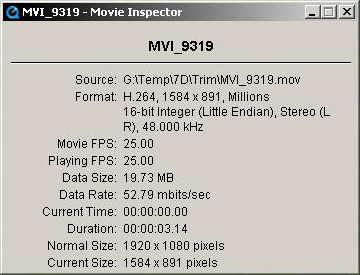

I did reinstall NeoHD but it didn't help but I know when problem happens.
NeoHD is working ok if the file is original from 7D. But if I trim original mov file with QuickTime player then HeoHD does not know correct frame rate.

Interesting. That points the bug at Quicktime Player, although I can't see why the frame rate would be changed. On the trimmed MOV clip what does the Quicktime Player movie inspector say the frame rate is?

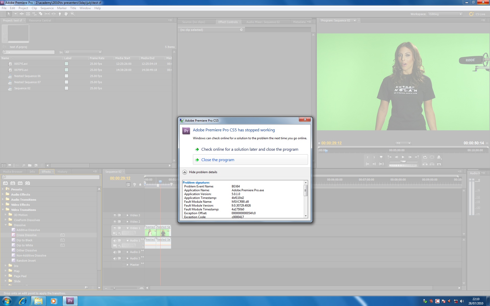

On this build and the previous 265 of NEO 4k, I get this error.
I am running Windows 7 64bit, Adobe Production Premium cs5 on a HP XW8600
I open a Cineform preset for example 1280x720 25fps I then opened two Cineform clips, nested each separate, then went to effects, transitions>Dissolve>Cross Dissolve, and dropped the cross dissolve between the two nested clips.
Also just nesting a clip can generate the DLL error as well. After I get this crash, I re-load Premeire pro and my project and it can crash as it starts to index/conform/peak files and then crashes out with the same DLL error.
You can see my Cineform test clips here
www,syncfilms.com/test/mxf_cf.zip
I tried turning off XMP in Premiere pro cs5 preferences as well.
Leo

Inspector is telling 25fps.

Please upload a short trimmed MOV (source file) that has this issue when converted.

Ok, I have file here.
http://kohan.1g.fi/Hosting/load/MVI_9319.mov
Hannu Korpinen is offline   Reply With Quote

Leo,
Interesting one. I can reproduce that. You can work around it be setting the playback engine to desktop, so this is must be a failure in our playback engine.

Hello David,
Would it be dificult to fix, also the other question I have is that in the cs3 Premiere preferences it has a player option, Adobe or CFRT what are the advantages/dis-advantage between the two? When working with Cineform material I presume it should be set to CFRT?

Hannu,
Thank you for the clip. I have reproduced it here. We will look into this tomorrow.

I did trim it from both of ends. Maybe it is loosing some information from origin.
