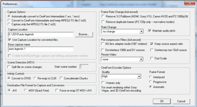

Any video footage captured with NeoHD doesn't fully show in CS4.
For example, I captured 45 minutes of film and can view all of it in Windows Media, but when I import into CS4 I can only view 1 minute of it.
Everything was working fine when i used ver 5.1.0, but after I installed 5.1.1 the problem started.
Even though i've uninstalled 5.1.1 and installed 5.10, the problem is still there which means I can't do any work work on my projects.
There are no problems capturing with CS4.
Attached is a screen shot of the options I use.
Anyone know what the problem could be?
