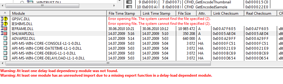

David, I tried Dependency Walker and that's what it gave me:
Warning: At least one delay-load dependency module was not found.
Warning: At least one module has an unresolved import due to a missing export function in a delay-load dependent module.
GPSVC.DLL: Error Opening file. The system cannot find the file specified (2)
IESHIMS.DLL: Error Opening file. The system cannot find the file specified (2)
There are also couple of DLLs highlighted (see attachment) with no error message next to them.
Could this be the reason of my troubles?
-Ivan
First Light: FLPlayer.exe quits after impoting cineform file-depwalker.gif

I expect not, only missing primiary level DLLs are typically an issue (although both DLL are present on my system.) You should file a trouble ticket with support to see what they suggest.
