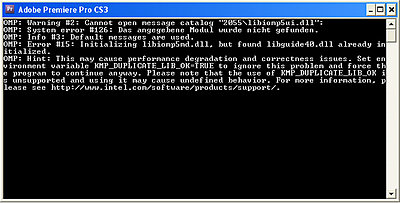

I recently updadet from Prospect to Neo4K, I installed the version 510 build 268 and everything worked fine. I updadet to 513 build 272 and premiere CS3 won't start anymore. I tried as well the 513 build 275 and it's the same. When I go back to 510 build 268 it works again. What causes this? I attached the error window which comes up during the boot of premiere CS3.
Any ideas?

Follow those instruction and the problem will go away. The has been a technical disagreement between Intel and Adobe on how certain Intel libraries are to be used -- this error is a result of that. Set that KMP_.. thing in the your system environment variables. In CS5 Adobe fixed most of those types of conflicts. It is likely happening in the later builds as we upgraded to a new Intel Compiler.

Thank you very very much for your help. This is really a great support you are doing here.
I tried this thing with the environment variable and it works, great.
Thanks again and have a nice time.
