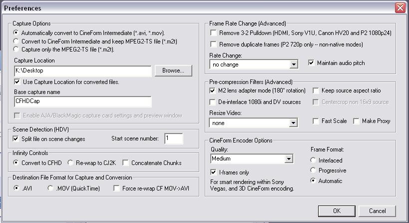

What do my settings need to be in HDlink to rotate footage? I converted something just now that came out rotated 180 degrees, but completely green. Attached is a screenshot of the settings I used. Basically just left everything off except M2 lens adapter mode. The file I tried it on was already a 1280 x 720 cineform file.
Also, how do I tell what compression level (Low, Medium, High, FilmScan, FilmScan 2) a file was converted at? I have mediainfo, and it says bit rate is 39.6 Mbps on this particular file. Are there certain bit rate values that correspond to certain compression settings? Or should I be looking at another value in mediainfo?
