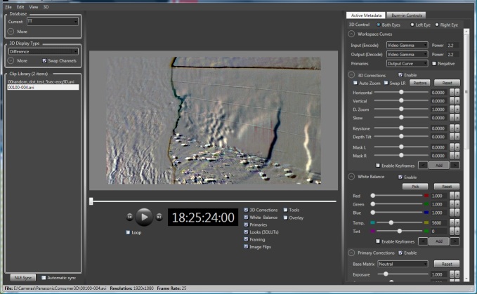

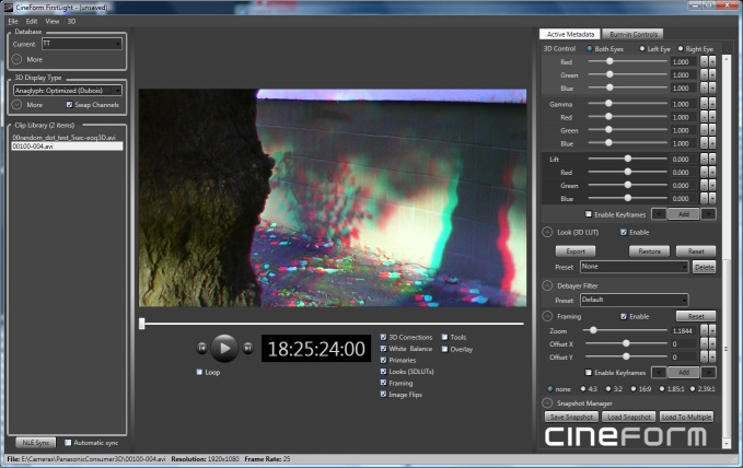

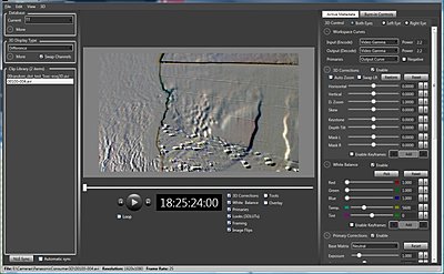

Old November 15th, 2010, 11:58 AM   #20
CTO, CineForm Inc.
Join Date: Jul 2003
Posts: 8,095
Originally Posted by Anton Galimzyanov View Post
hi David
I've installed a demo version on a second machine - yes, it does work and convert 3Ds fine. Hm, strange..
BTW, what do you mean by 'fixing the vertical offset' ? Are those windows not correctly Y-centered ? If so, could you share with us a correction numbers. Thanks
Seems that the 3D lens on the SDT750 is not alsways perfectly aligned. This is easy to correct for.
Load the 3D converted sequence into FirstLight and enable the differencing mode.
From here you can adjust the vertical to remove that strong black line (error between the two eyes.)
In the corrected image I used -0.0038 vertical adjustment (a -0.38% shift or around 4 pixels.) I also did a horizontal convergence change to place the tree at the screen plane (-0.0049). In the Framing panel I set the zoom to 1.1844 to remove the black borders. This set the display to Anaglyph for web viewing.
