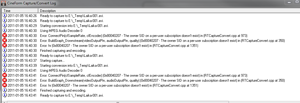

I also cannot capture HDV->CineForm with HDLink/Neoscene. Was about to submit a support ticket, I didn't know this was a known bug.
How can I download the 261 build? I cannot find any mention of downloading older builds on the site.
Many thanks, Jon.

Finaly I can capture HDV from HDLink :)
I hope you guys at CineForm fix this bug soon. I know HDV is a dying format, in fact I myself bought NeoScene only when I got the 60D. But now that I have it I would like to use it for my HDV captures as well, without missing out on the improvements of new builds.
For what it's worth, here's the error I was getting in build 288, under W7x64
