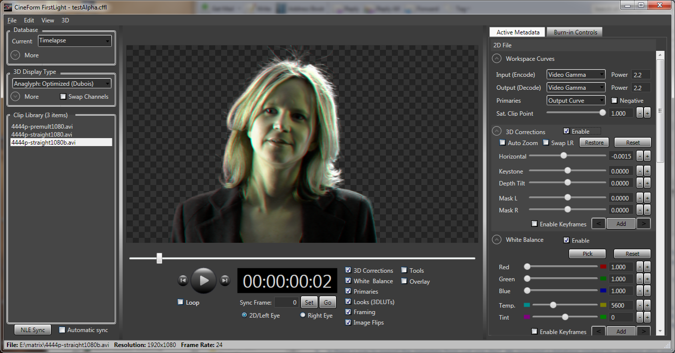

This one is mainly for Neo4K and Neo3D users. Alpha channels have been support by CineForm for many years, it even predates FirstLight and Active Metadata corrections, but it was never update to support AM until now. You have now so all your color correction, framing and 3D correction with files that have alpha channels.
PS. If you want do a mix down to a checkerboard, like shown below, you will need to add a defaults file as the UI has yet to updated for the mixdown options. Yet me know if you want this for FirstLight.

Hi David,
yep, an option to enable/disable a background to be able to see where the transparency is, would be very cool.
I also like to see an option to see only a single color channel R, G, B, A selectively (or have I overseen that?).
Will the new version fix the export of alpha channel layered rendering in Premiere CS5 as well?

Posts: 8,095
Refreshing the above beta links for Neo4K and Neo3D, should be updaed in 30 minutes. We now have alpha channel exports from Premiere.

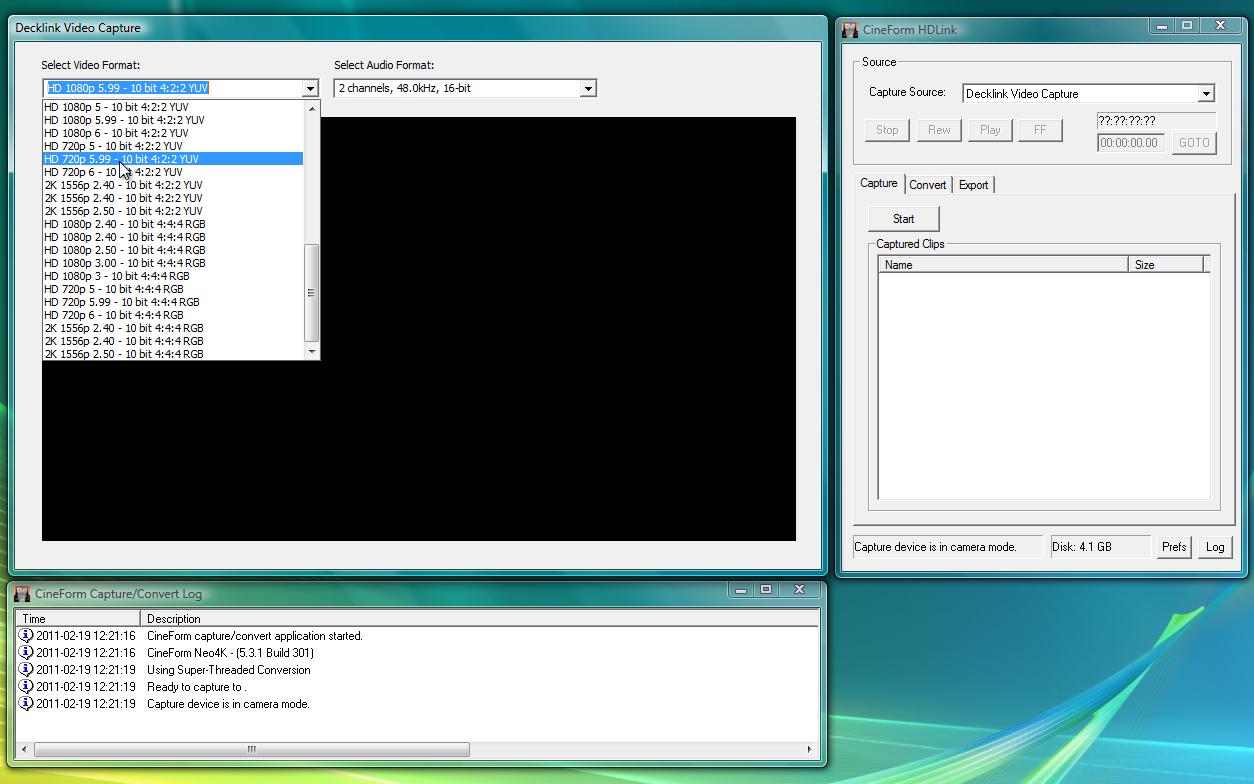

DeckLink strange framerates
Hi.
I have the latest DeckLink drivers installed.
If I use DeckLink input to capture in HDLink then I get wierd framerates displayed. See enclosed screen capture.

Posts: 8,095
We have tried to fix that BMD display rate, something in the sample code they provide (so I am told.) It is completely cosmetic, just time the number by 10. The pairs of 2.40 are 23.976 then 24.0, always in increasing frame rate.
Old February 20th, 2011, 04:46 PM   #9
Join Date: Oct 2009
Location: Turku, Finland
Posts: 30
OK.
I hope this cosmetic problem will still be fixed.
BTW, why is there no interlaced modes in the list?
