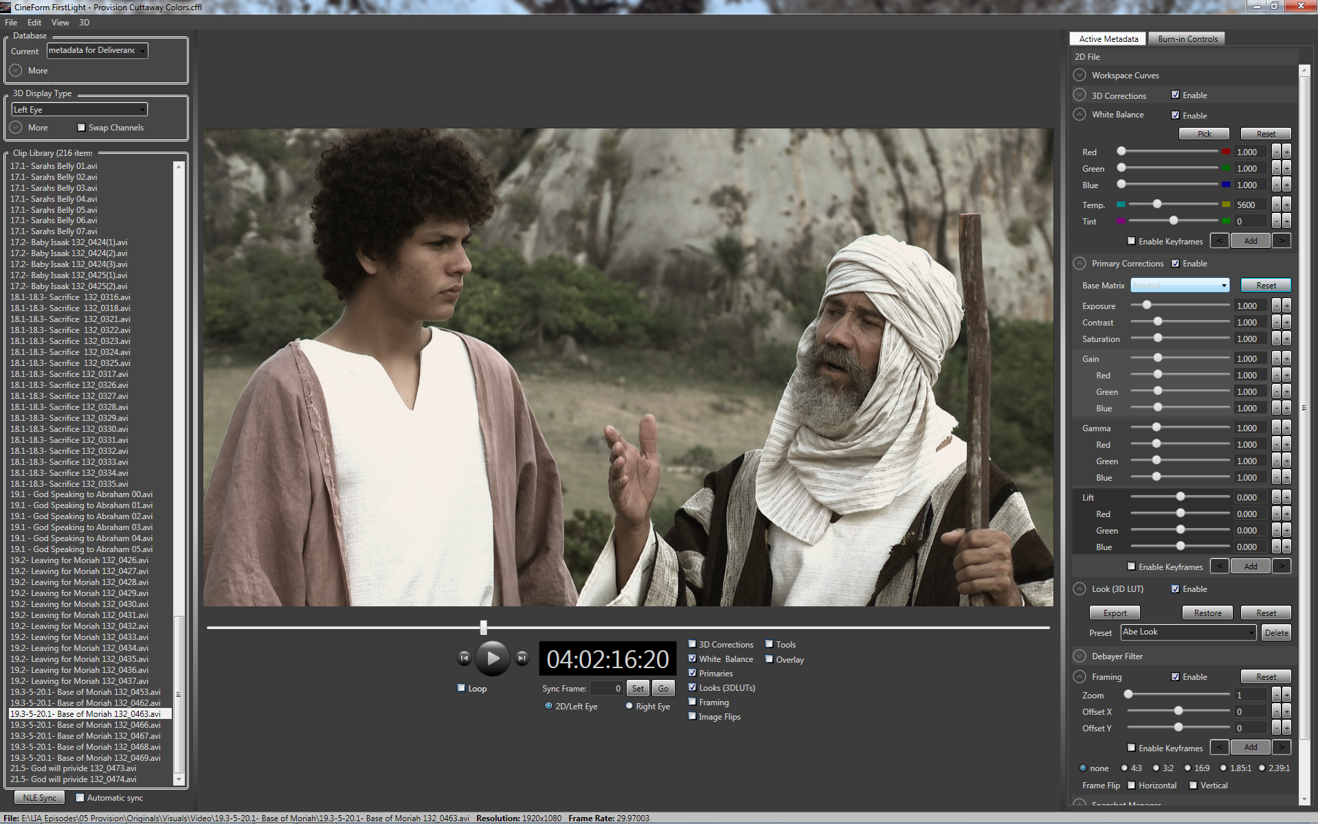

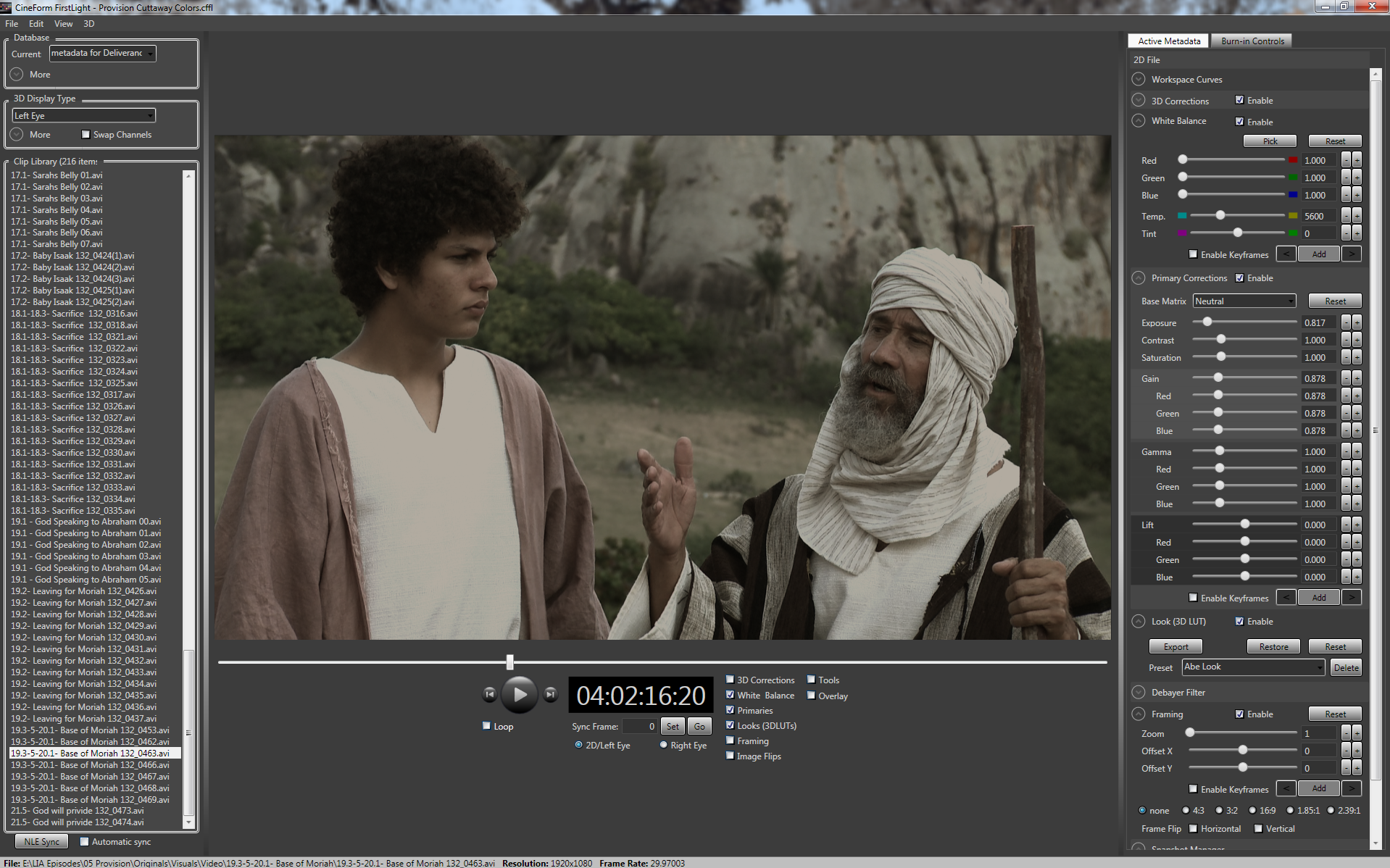

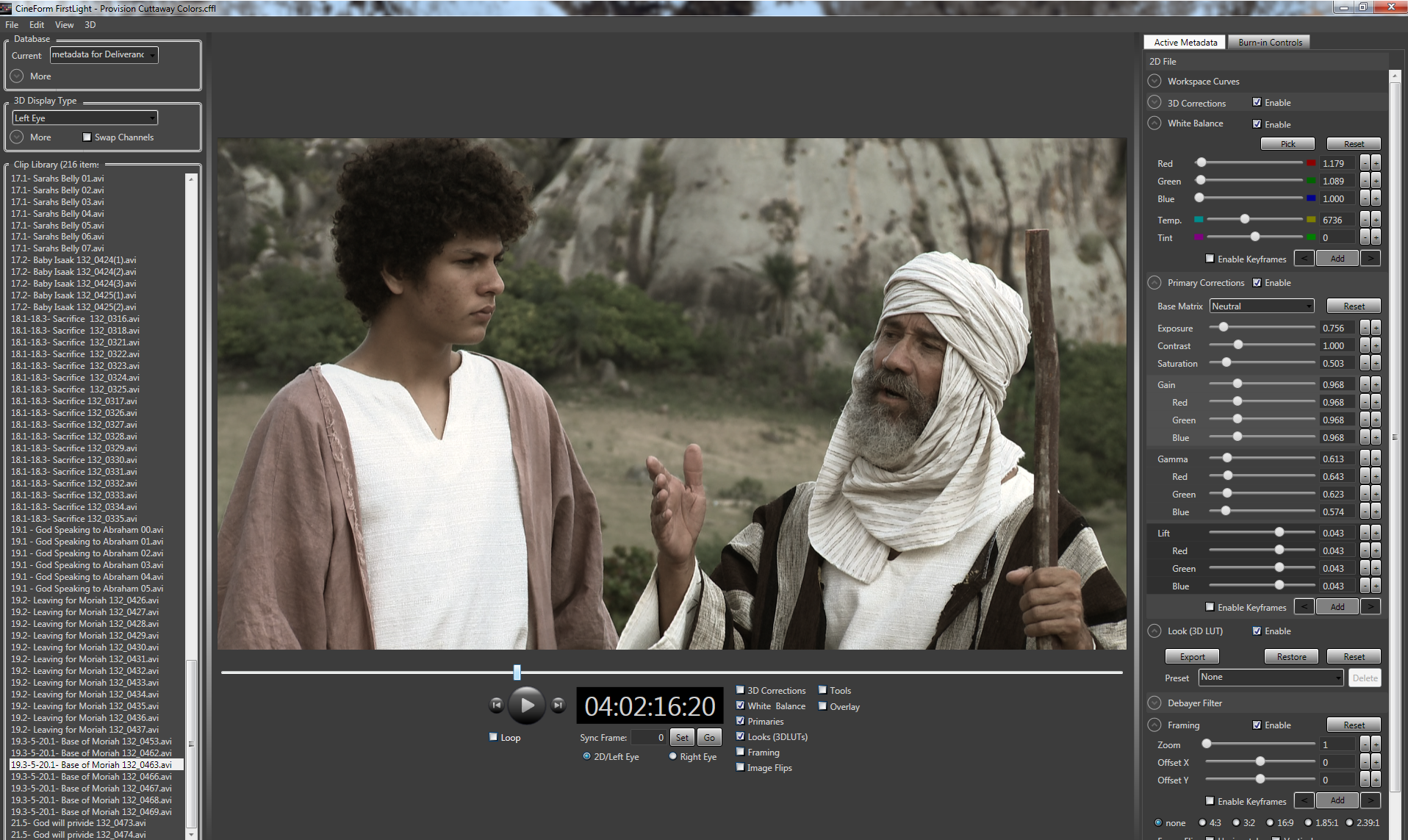

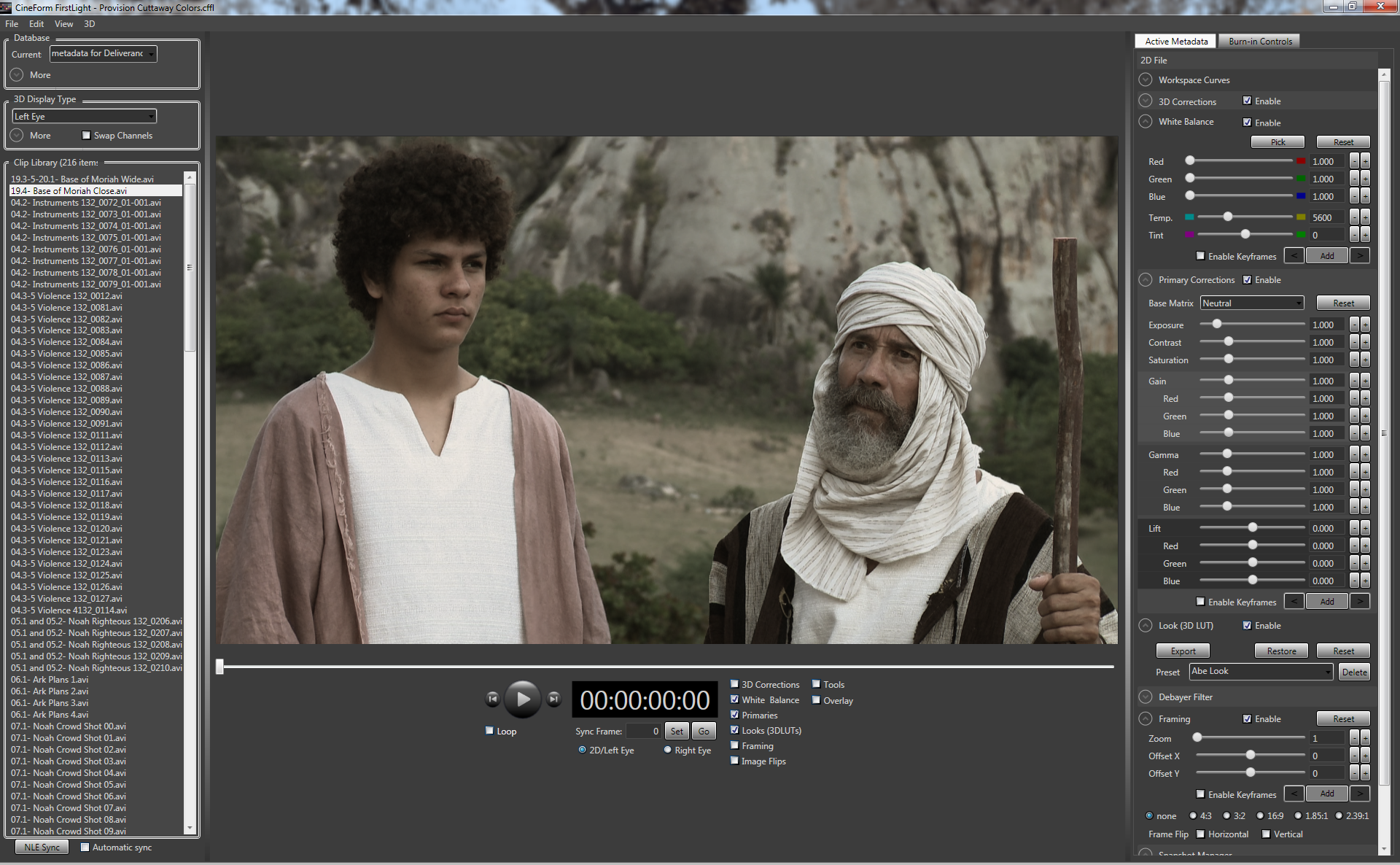

We often have 80-100 clips open in FL and grade them before doing our post and VFX work. One thing we've noticed, is that unless we first pull the gain down to recover lost data in blown out areas, then render a copy in AE, we'll lose that data if applying the LUTs in FL first for colorgrading.
We are working with Cineformed (NEO 4K) EX1R files and I am attaching 4 png's to show what's happening:
"No Look- Not Blown Out.png" is just using the primary color correction and white balance controls, no LUTs used.
"Look Generated then Applied- Blown Out.png" - a LUT file is created from those settings, then applied to the reset image, with no color correction or white balance applied. It's all blown out and the data is non-recoverable.
"Gain and Contrast Reduced- Still Blown out.png" is to just show that you can't recover that data from the above scenerio.
"Look Applied to Rendered Footage (gain reduced)- Not Blown Out.png" shows the difference between first rendering the image with the gain reduced, then applying the LUT in FL. What a difference!
How can we avoid this "having to render video" step with FL and with LUTs? Is there any way, without having to adjust each and every clip and without having to "copy/paste" from some other clip?
The LUTs seem to kill any gain settings we save!
Detail in FL lost unless hardcopy saved with gain down-no-look-not-blown-out.png   Detail in FL lost unless hardcopy saved with gain down-look-generated-then-applied-blown-out.png
Detail in FL lost unless hardcopy saved with gain down-gain-contrast-reduced-still-blown-out.png   Detail in FL lost unless hardcopy saved with gain down-look-applied-rendered-footage-gain-reduced-not-blown-out.png

Apparently we are misunderstanding your workflow, then. We do set the WB and gain first, but if a LUT is then applied to match color with previous footage, the white areas are then blown out by the applied LUT. It does not seem to matter what the gain setting were when that LUT was exported. Even one exported with a lower gain setting does not keep the data from being lost in the highs.
The reason we included the same footage in various ways, was to show you clearly the issues. We are not making a LUT for each clip, if that is what you mean. Please look at the highs in clip #2 and #4 for examples.

No, that's why we sent you the screenshots. You should be able to see that clearly from the settings. Reference the last image. We applied a LUT (exported with the gain down, see 1st image and gain settings) to the original image. But when applied (see last image), the image is blown out and the detail in the highs is gone, gone, gone. The whole process is very clear in the 4 images, which show their settings
