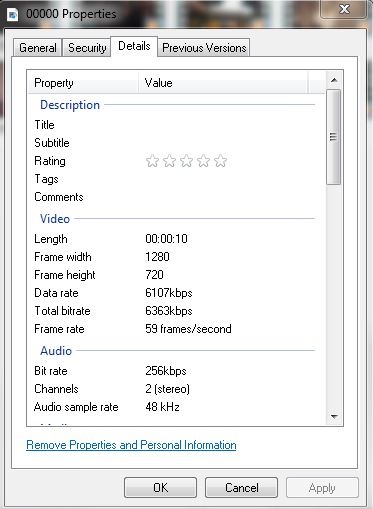

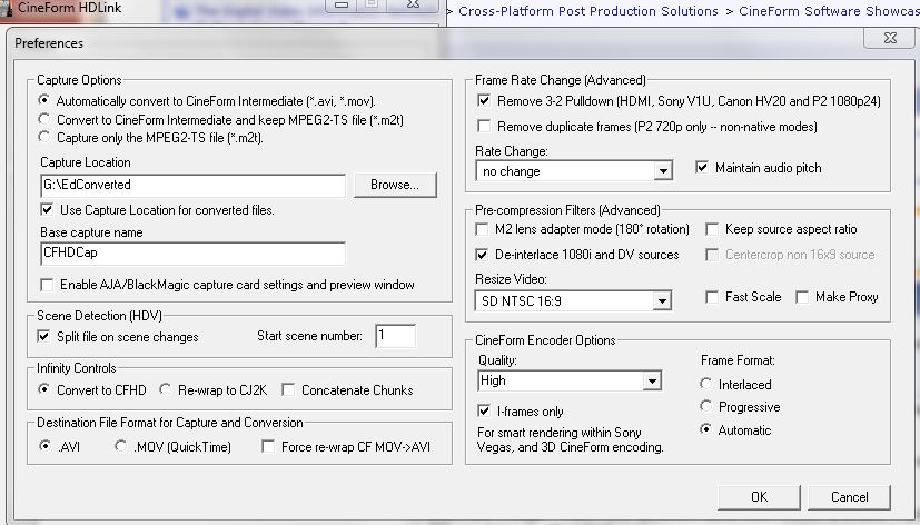

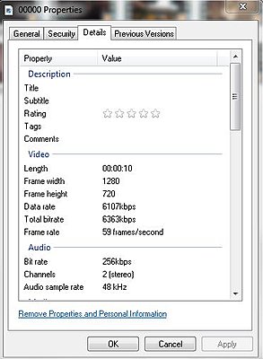

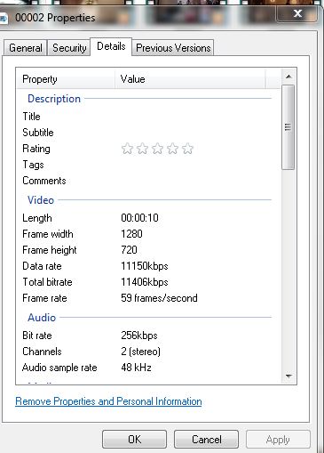

Ok, HD Link works great converting the GH2 footage I shot saturday. but with the GH1 footage that I shot, HD Link converts about 1 minute of video in about three hours, no exaggeration.
I right clicked in the windows folder and noticed in properties/details the bitrate for the clips vary a lot. Is this why things are not moving along? In addition, upon some clips the program will enter a state of "not respondiing", but that will clear up, but then process at the snail's pace I described.
Is there a setting I should change? I have more questions about other issues unrelated I'll post later, but in the meantime anyone have any thoughts?
I have tried with and without keep source aspect ratio checked, same result.
Edit: Also just tried with "remove duplicate frames", which seems to have helped a lot. It still seem slow, but it is a least moving.

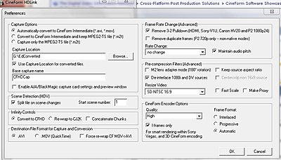

My personal preference is to un-tick "split file on scene changes" when doing lists of converts and to send the converts to another folder. I notice from your third screen grab that you have left "split file on scene changes" ticked.
With Sony Z1 HDV files on an older Prospect version, leaving "split file on scene changes" ticked caused unpredictable behaviour and stalled converts when more than a few files were listed.
Sometimes, the HDV captures had glitches in them. These I think cue HDLink to interpret a camera stop-start and to create another file at what it sees as a scene change.
Neo has come a long way since those days but a similar issue might exist as I note you refer to your camera as a "hacked" GH1. I am not knowing enough on this topic so please regard my comments as a guess only.
Another personal preference is to capture first and then do the converts in a separate step. It is less demanding on the computer. I note you are capturing and converting in one step as you have not ticked "capture only the MPEG TS file".
You also converting to SD NTSC 16:9. Is there a special reason for that?
Your current HDLink preference settings make a lot of work for your computer to do during a live capture.
