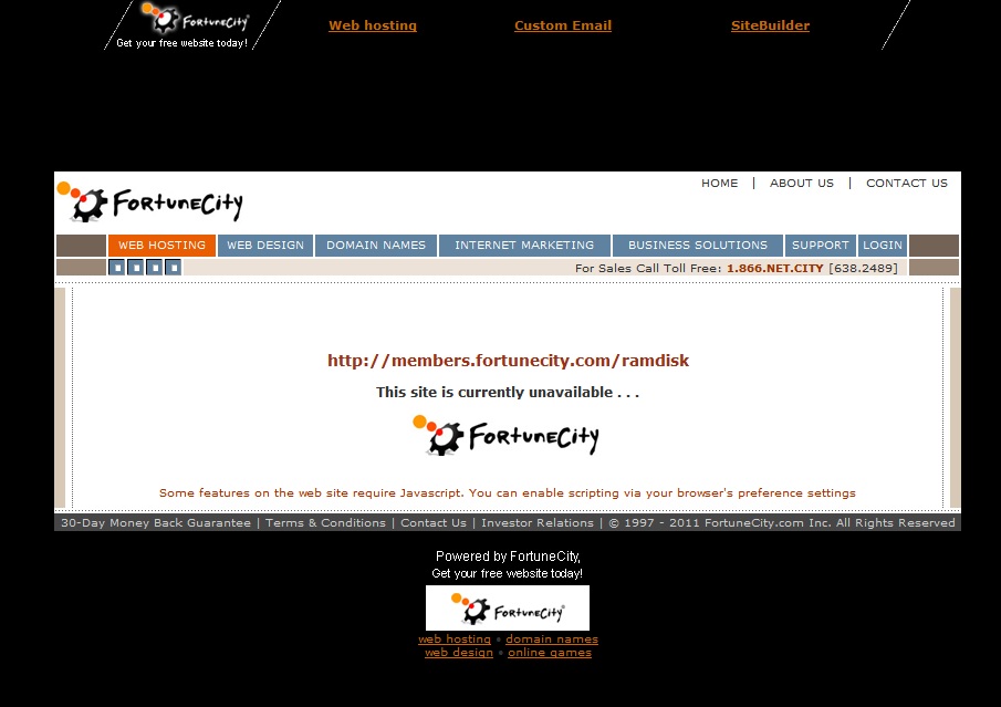

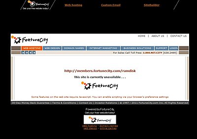

Old March 24th, 2011, 07:35 AM   #14
Location: Natal, RN, Brasil
Posts: 900
Re: HDlink and CF output use only one core?
Weird. I still can't access it and couldn't find it Googling it! We're located in Northeastern Brazil, so who knows what's up.
We've been having some really strange DNS server probs for weeks and I've been swapping new DNS servers in and out of our router to try to re-route to troublesome URLs.
Attached is the screenshot I'm getting. If you've got a direct link to their download, I'd appreciate it.
