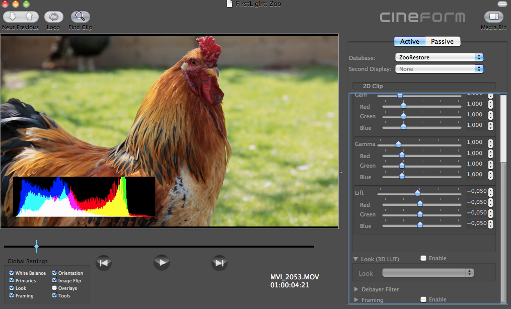

Well... I have a clip selected....
What I meant with opening a new FL-project was, that since I installed the new NeoMac version any new projects don't get keyframes.
But all old projects that already had them, still do.

There are 2 possible reasons for the keyframes controls to be invisible on the Primaries. 1) if you have a 3D clip and have selected a single eye, and 2) the source does not have the embedded frame number metadata.
Since your clip is clearly 2D, I suspect the latter. Select the "Passive" tab and open the "CineForm" group. You need to see an entry that says "Unique Frame Number" to be able to use keyframes.
Craig Davidson is offline   Reply With Quote
