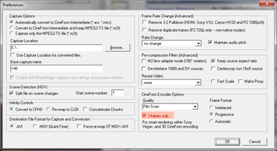

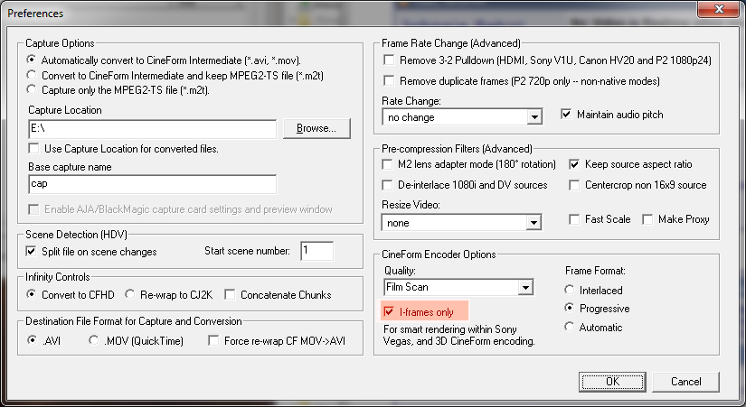

Old May 6th, 2011, 09:04 PM   #6
CTO, CineForm Inc.
Join Date: Jul 2003
Posts: 8,095
Re: Video is flashing when encoding with Mpeg stream clip
See attached pic.
Old May 6th, 2011, 11:08 PM   #7
Join Date: Apr 2003
Location: Vienna/Austria
Posts: 187
Conclusions:
1- I am blind
2-Never be jealous at the Sony Vegas people around 3 A.M since they have a smart rendering feature in HDlink called "Hrames only" (I-Frames only) that we in Premiere don't have.....:)
Problem solved,
David, thank you again!
Johnnie
http://www.johnniebehiri.com/
