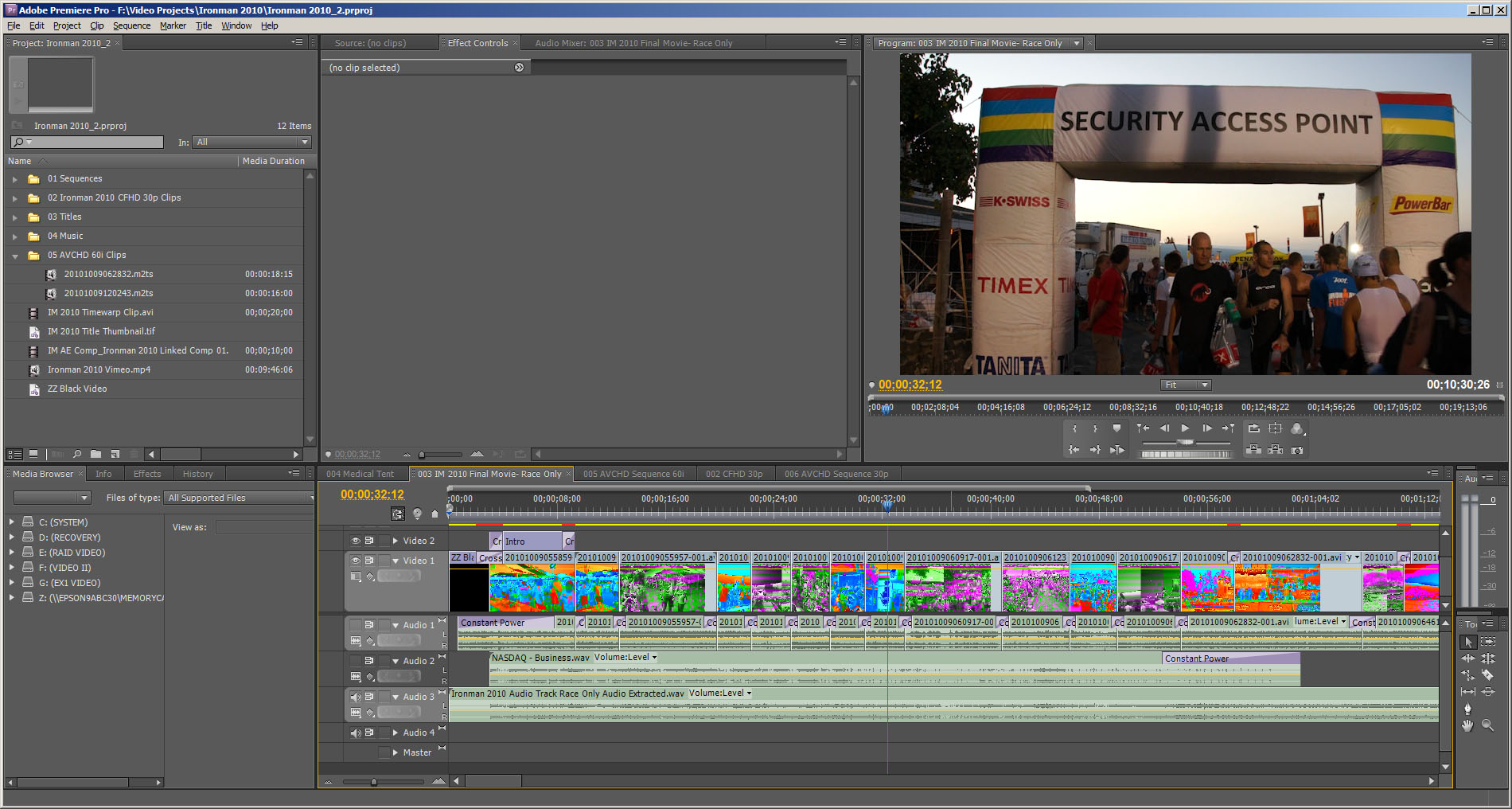

Here's a screengrab- you can easily see the problem on the timeline clips
CS5.5/NEO5.5-Bizarre Timeline Thumbnails-cs5.5-screengrab.jpg
Bob

It only impacts IP files (not I-frame) and only on the thumbnails (fixed soon.) It will not impact exports. If you having export issues update you software, then contact support only if the exports still fail -- I have tested that it currently working fine..

Today's release of Neo 5.5.1 seems to have cured my timeline thumbnail problem
After install of the new version, all of my CF timelines in all projects look perfect.
