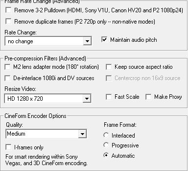

To edit 720p footage with ease, and to have the ability to deliver the end product in both Bluray and DVD (I'd need to deliver both Bluray and DVD to this customer) would I then:
Use HD Link to convert to HD 720 cineform files, edit Cineform files Then I would render to Bluray specs from Vegas, or to 720x480i as desired? Does that sound like a sound workflow to give me the flexibility I need here? I believe Vegas will interlace the progressive footage just fine, right?
And the Cineform files produced (using the settings as shown in the attached image) will produce good results for Bluray?
Thanks for your assistance.

I wouldn't downscale in HDLink if one of my outputs is BLuRay, and would use High not Medium quality. Leave the scaler off. If you know your source is progressive, set that frame format.
