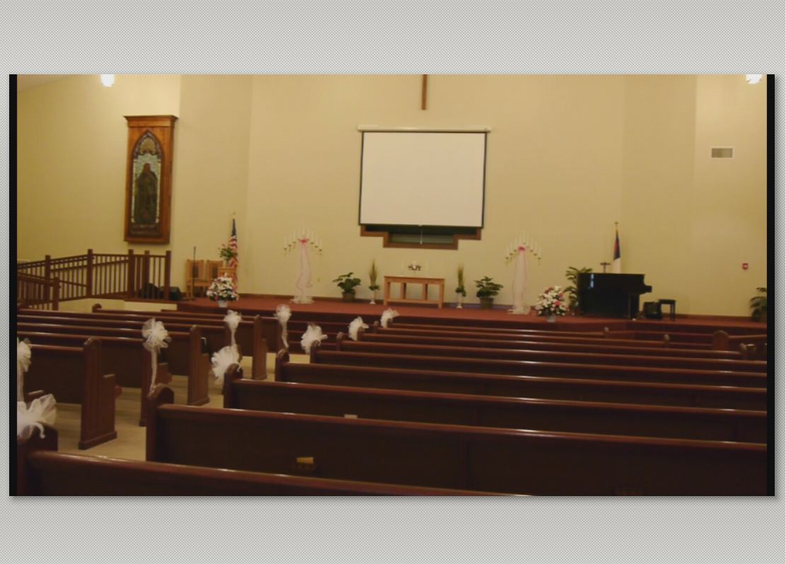

David, here is what 1280 x 720 looks like on 480 16:9 DVD.

1280 x720 means square pixels and is for HD, not DVD; it is not the same as 480 16:9. The PAR when using a 16:9timeline is 1.2121, not square.
Am I wrong? If I follow your instructions I get black bars when I make DVD. I know that because I just did it. You have a separate NTSC 16:9 setting in HD Link, apparently I need to use it, even though you don't agree.
That is unless I use a NTSC 16:9 timeline with the 720p Cineform files, and crop the footage on the Vegas timeline after having just converted it. Which on the surface doesn't make sense, but what do I know? It just seems silly as the whole purpose of conversion is to make it suitable for DVD, not Hd. Maybe that is the best thing to do, I don't know.

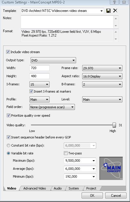

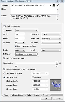

David, so if I take this all the way through for creating a DVD with 720 60p footage:
1. With HD Link, create an intermediate and do not resize using the 16:9 setting but leave the size as is. Leave progressive, do not interlace.
2. Bring intermediate onto a 16:9 30p timline as shown in attached image.
3. Crop footage on timeline to fill screen.
4. Edit project.
5. Render out to 16:9 30p as in attached image. (30p footage will work fine on DVD without adding pulldown flags, right? I don't have the ability to add pulldown flags for 30p, anyway, but I'm just checking). Mind you I don't know what I'm talking about, I just know that for 24p pulldown flags are normally added when using Vegas, there is not such option with 30p renders, at least in Vegas.
6. Import file into DVD authoring program, etc.
Does this sound right?
720 60p conversion-project-properties-vegas.jpg   720 60p conversion-render-settings.jpg
Old June 25th, 2011, 09:48 AM   #14
CTO, CineForm Inc.
Join Date: Jul 2003
Posts: 8,095
Re: 720 60p conversion
Yes. 3 is optional.
