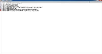

Had six hours of sleep then got up and tried the proxy thing and got an error message.
Chances are this is my incompetence given my bleary-eyed state. However any advice appreciated. A jpg of the screengrab appears below.

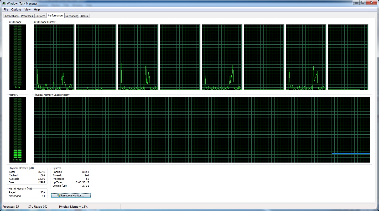

Furthur to above, it seems I might have broken HDLink as a convert to a 1280 x 720 also fails.
Going another route, importing to PP CS5, dragging a clip onto the timeline then exporting it as 1920 x 1080 without any effects being applied is an exceptionally seriously slow process. Reproduced below is a jpg of the system usage graph which suggests the computer is sleeping for most of the task. Any clues on where I am going wrong will be much appreciated.

Old August 18th, 2011, 11:40 AM   #10
CTO, CineForm Inc.
Join Date: Jul 2003
Posts: 8,095
Re: Proxy files. How to create for FCP7.
Are you using the latest version (try the beta.) Seems to be working fine here, 2K RAW to 720p or 1080p. Follow up with support if this continues.
