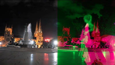

I have OSX SL. And trying the AE CS5.5 trial due to the warp stabilizer.
I rendered out a 1 min sequence from AE to CF (75% quality). After hours of waiting, I open the file and the entire footage has artifacts.
I have attached the file and opened a CF support request.
Prores renders are not an issue. Just wondering if any AE CS5.5 have had issues with CF.
Is there a problem with CF export and AE CS5.5 on OSX SL ?-screen-shot-2011-09-19-9.49.10-pm-2-.png

I was getting same result out of AF CS5.5 and was given this (successful) strategy by Cineform support:
"Do you need the alpha channel? If not, try exporting just 4:4:4. That seems to be working okay in our recent tests....
If you do need alpha, make sure that 4:4:4 is not checked and 4:4:4:4 is checked. If you have them both checked, that will cause a problem."
Works for me.

YES/ The 4:4:4 options fixed the problems.
Works well now.
