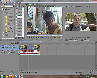

The bugs (up to now) with Vegas Pro 11 for me are with Cineform files too.
In a project with Sony MXF 1920X1080 23,97p clips and Cineform NeoHD 1440X1080 23,97p (converted from HDV) in a 1920X1080 23,97p project, the MXF clips display fine, but the Cineform files are distorted.
I attached a screen displaying in the source window a Cineform frame and in the timeline window a MXF frame.
Vegas 9.e and 10 doesn`t show this bug.
Anyone can help?

Ron - in response to your thread hijak! (only joking) try right clicking on each of the source files with distorted aspect ratio. Select properties and in the media tab have a look at the pixel aspect ratio. You probably need to change it.

Thank you Stuart. I didn`t notice I was hijaking this thread.
My project (a feature 90` documentary) has more than 500 Cineform clips, so to do your sugestion doesn`t seem to make sense now.
And, as I said, when I open the same project (or play the same Cineform clips) with Vegas 9.e and 10, this bug doesn`t show up (despite with Vegas Pro 10 the project tend to crash when I try to work with it).
So for me it`s clearly a Cineform / Vegas Pro 11 bug.
